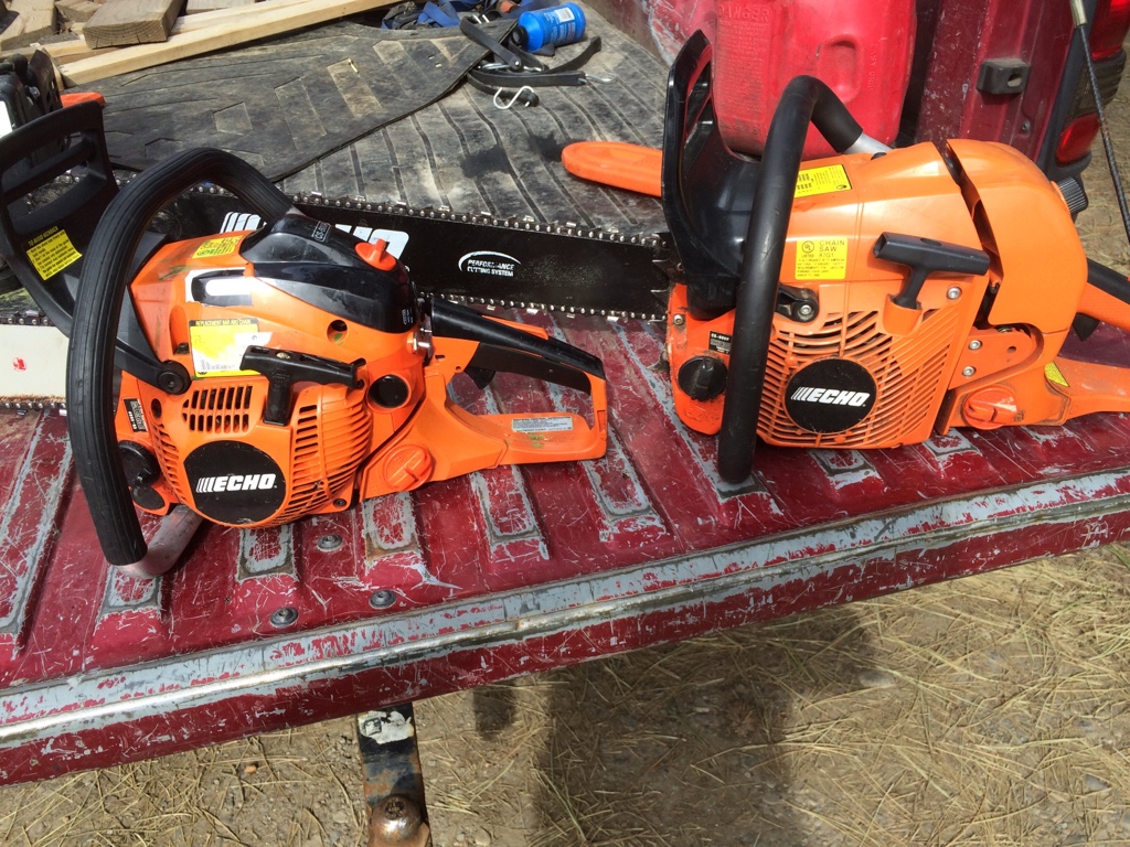

I think I have a good 1-2 punch here now.
600 runs good, will be better once it has a mastermind sticker on it ;)

I gotta get a new video camera and tripod so I can shoot some video.
The 500 definitely woke up with the little work I did.
Still doesn't rev up as fast as I thought it would. Needs more fine tuning.
Running 20" 3/8 full comp it pulls down but doesn't quit.
