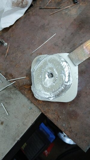

Tig weldded up the head I cut off last night. When I faced and turned it to cut the chamber and seal area, full of porosity. Have done a lot of aluminum tig over the years and if theres no indication of that during welding, it usually comes from hydrogen dissolved into the aluminum and precipitating out as the temp drops during solidification. I machined it all off, cleaned up the back side, checked everything, did a test beqd on so.e 6061 and hit it again. Same *s-word. I think its in the china cast. I have welded some alloy wheels that behave the same way.
New plan. Sacrifice another jug to the chainsaw gods and skip the welding.

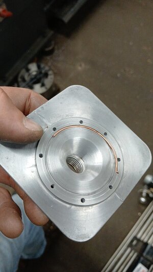

The aftermarket jug was not the best but we will see how it runs. I have 2 other cylinders I havent touched yet. Tunneled out the lower transfers quite a bit, had to tig up the jug. Way more than I normally would go. Didnt touch the piston. Couldnt go lower with the jug or it would free port. The transfers were at 121, so I raised the exh to 99. I opened up the rest of the transfers a little and swept them back more. Intake was 64, haha. Took it down to 73.
Cylinder head was cut off a strato saw jug. Head is sealed with eight 4mm bolts, with a 0.040" copper wire in a groove about 8 thou proud. It has about 50 percent squishband, depth mics say squish should be around 17 thou, if my copper wire copresses the full 0.008". Well see, havent bolted the head on for good yet.

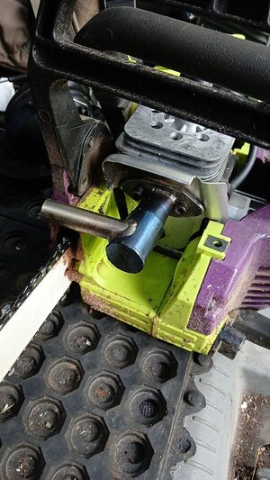

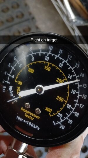

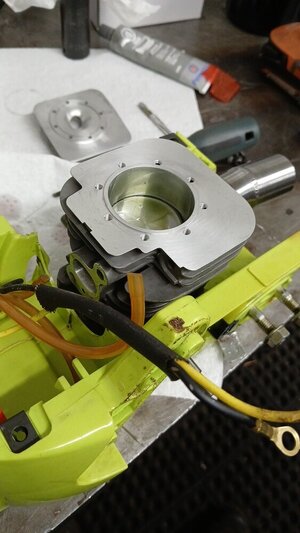

1000002542.jpgCouple pics. Never tried making one of these pipes before. Need to compare to the muffler, but seems to have a wide powerband. Might notch the piston for more intake and see how it likes it. For now I'm pretty happy with it, all it is really is a novelty play saw.
First test tonight with a dull semi chisel chain. Going to put 325 on it I think.

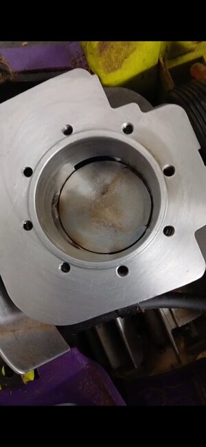

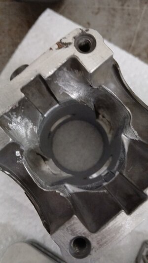

1000002760.jpgThoughts? Notice there is a tiny thin line of carbon at the intake wall. Looks like some short circuit going on, but actually uses very little fuel and doesnt stink. Should have done another and kept the upper transfers tighter to compare. It runs very very well for a little saw though.
Also, I usually see more wash on the flywheel side. This is opposite. The transfers open at the exact same time, and are the same. Wonder if the lowers are flowing a little less/more or something.

Anyone with any insight on that wash pattern? Whats with the real thin line of carbon right at the intake side cylinder wall?
