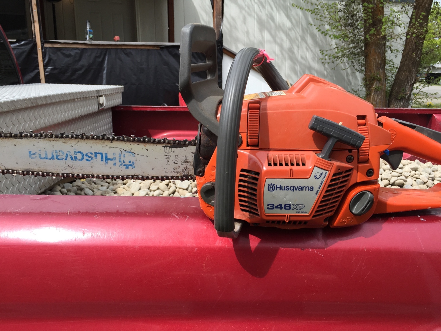

Gonna throw a fresh .325 at the 346 and cut a couple cookies with it today.
Not a fair comparison with the 500 running full 3/8, but both have similar compression.
Ran my buddy's EC ported 346 yesterday. Yes it was impressive, but my stock one sure revs up quick.

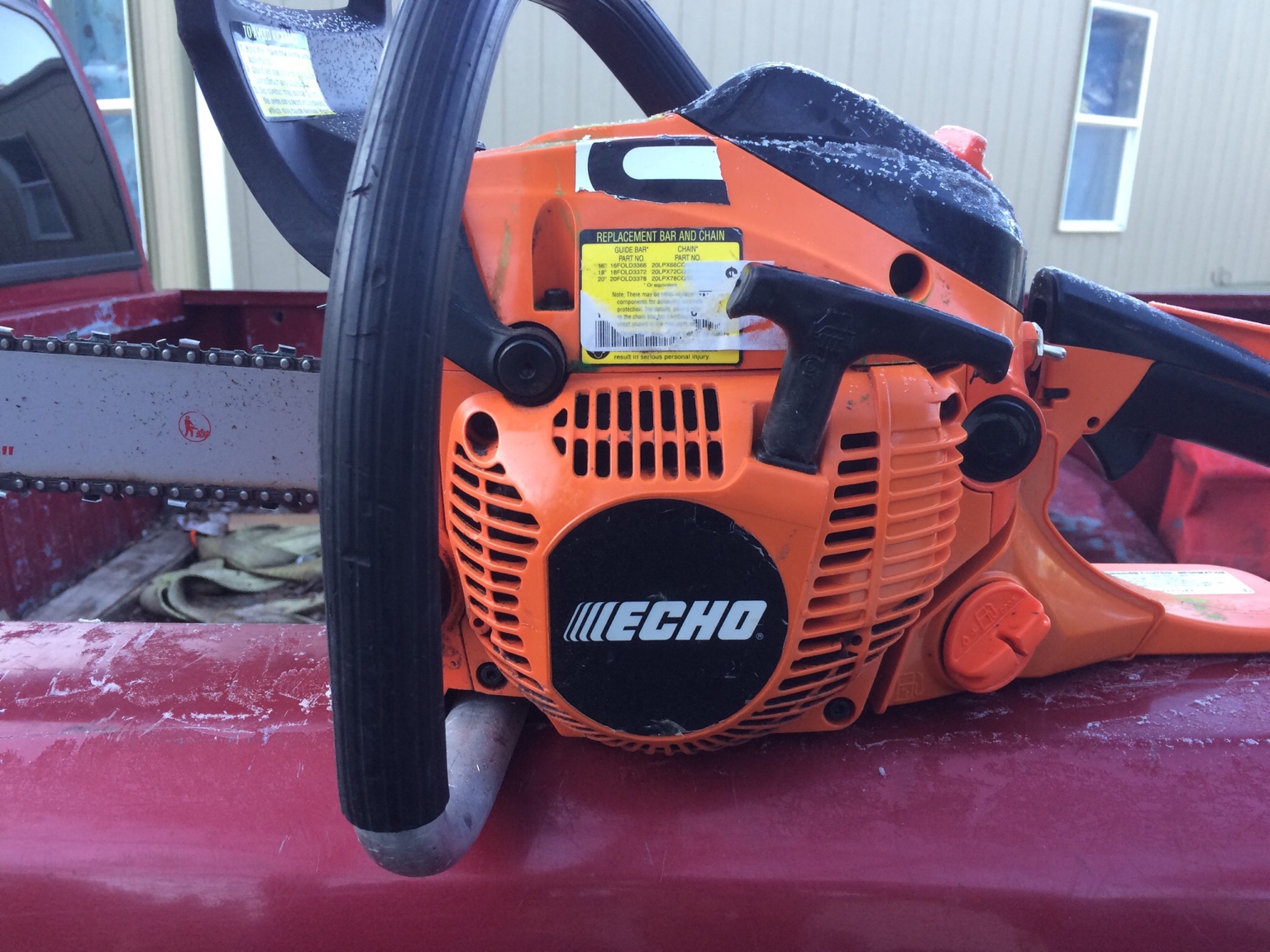

500 just had that Echo torque I like though
