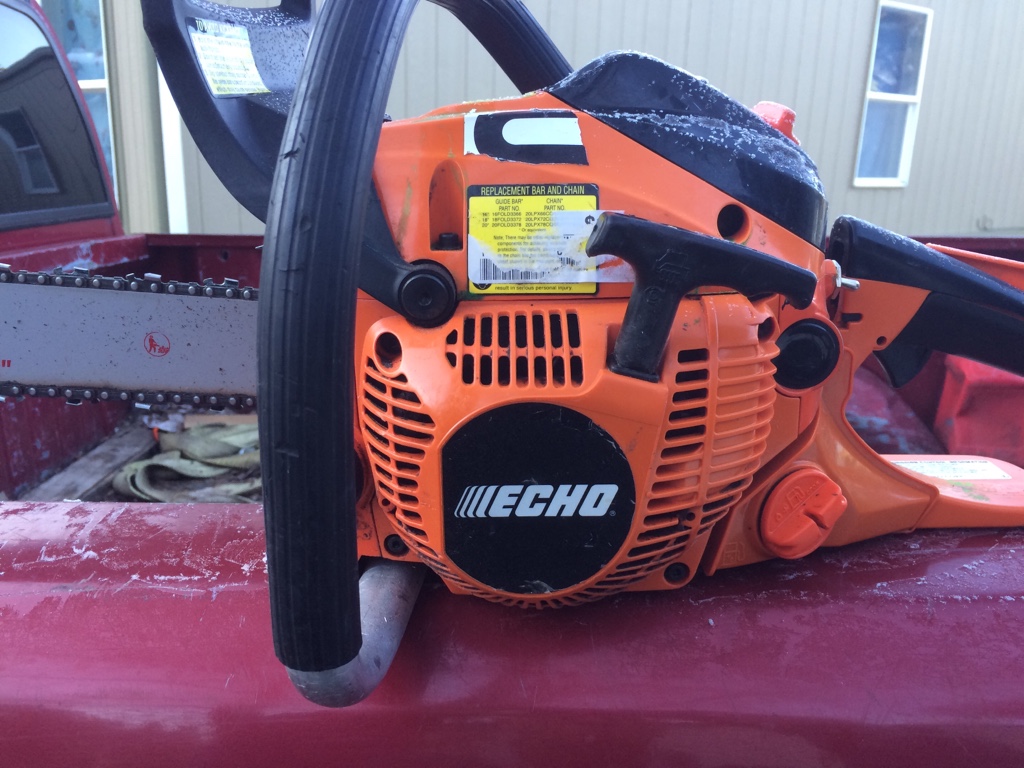

Here's my pawn shop 500.
I'm wondering if it started out life as a Home Depot rental saw?
It's clean and runs.
Haven't checked health on it yet.

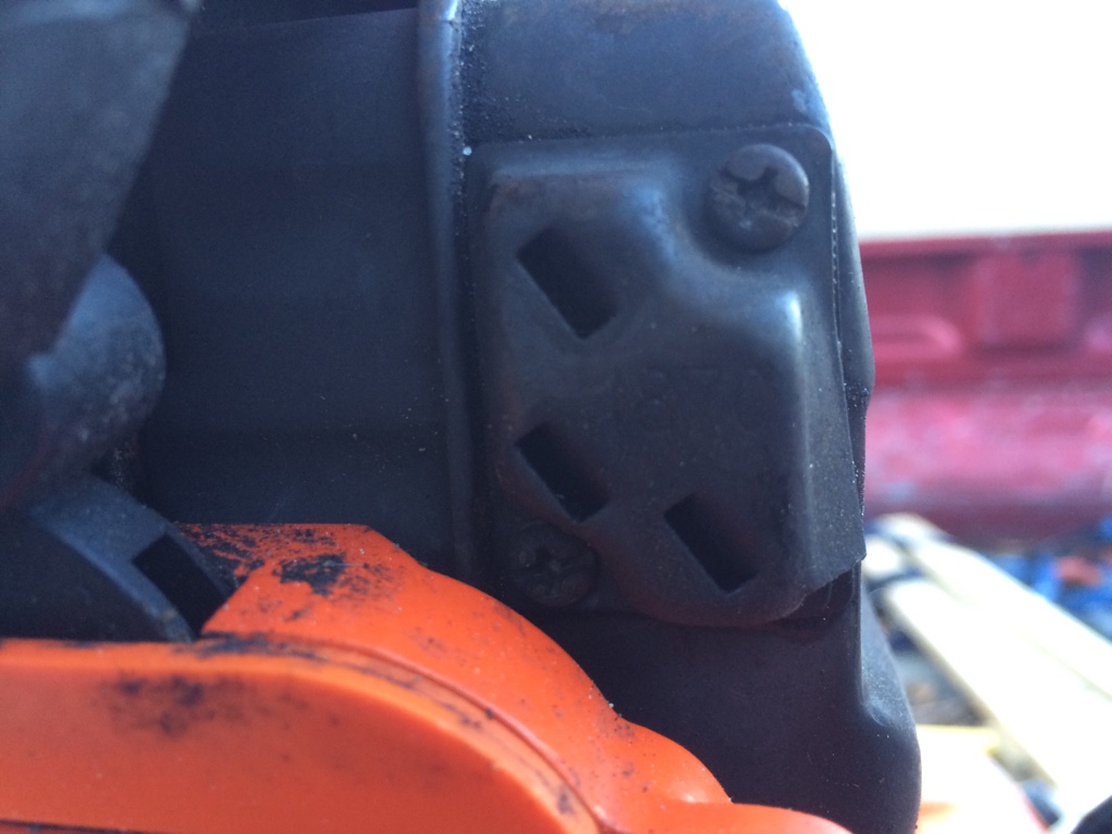

Gotta be the most restrictive outlet I've seen on a saw!
Ouch. That looks terrible

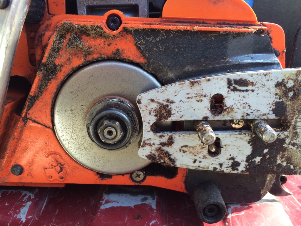

Anyone think of a reason I couldn't put a 3/8 rim on this and just use one of my d176 bars?
The upper adjuster hole lines up with the oiler just fine and it's opened up to the bar groove, so should oil just fine.
Oregon sells those I bought a couple for my echo don't know where my 325 is anymore cause I been happy with the 3/8
.325 would cut faster but 3/8 will stay sharper longer.
