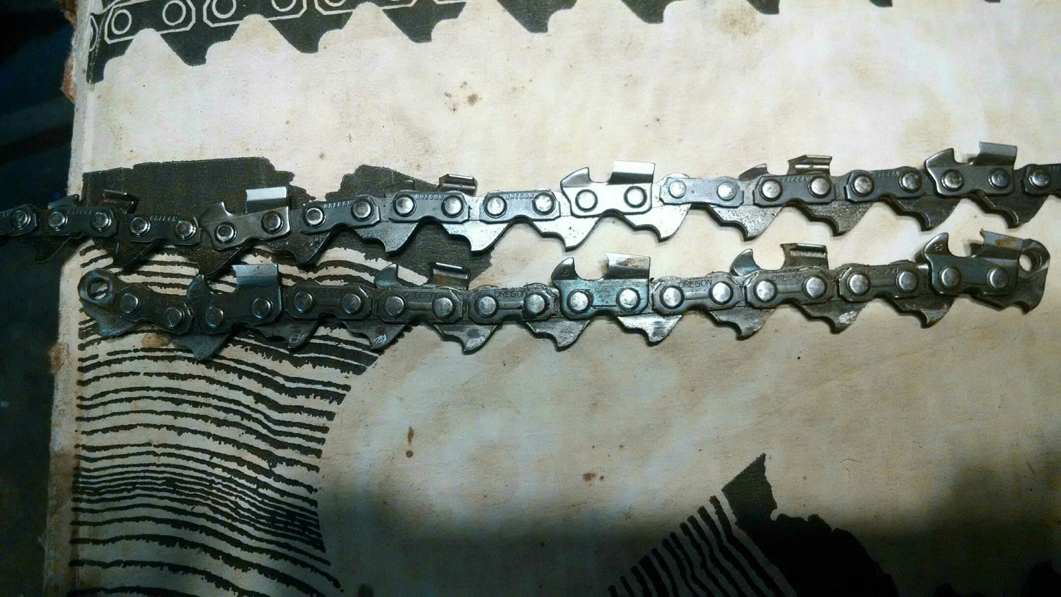

It sure looks that way!
76lg top 72lgx bottom.
