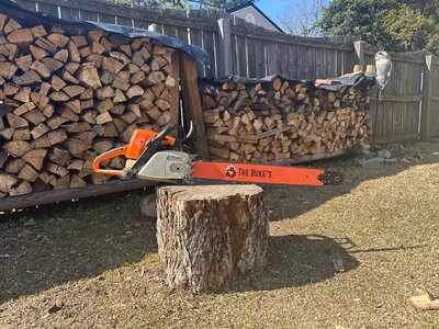

I measured the rim tonight at each of the seven points where it steps in. All checked the same.

Went back to messing around this morning, took the whole drum and rim assembly off, put it back on.
I think it was some casting imperfections on the inside of the rim where the drivers sit. After running it a little more and cutting it has gone away
Very strange. I’ll be keeping my eye on it. Mounted up my 28” that showed up with the Mike Gott semi skip. No issues. The drum is a Mini 7 spline so I couldn’t try the Oregon rim

Well, the plot has thickened. Got bored between periods of USA hockey. Mounted up a used chain on the Oregon bar again. The situation returned. Move the chain 6 inches and it grabs the bar.
Now I’m leaning towards the bar being involved

I’m thinking I will mount up the original 325 OEM sprocket, bar and chain.
If it does it there I will know it’s internal. Tensioner, hopefully not bent crank as mentioned above. Not sure how the crank would become bent. It was a very low hour saw. Didn’t appear to have ever been disassembled even to clean behind the clutch cover
