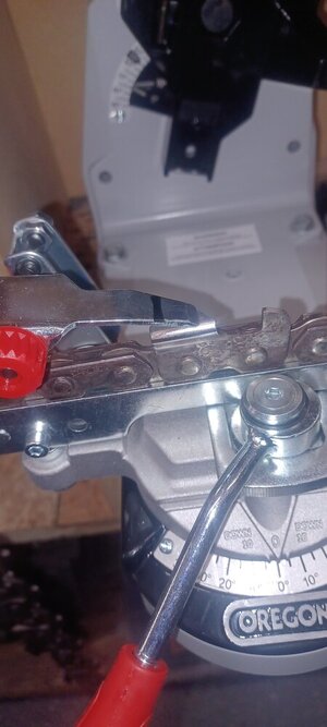

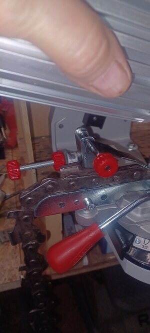

I got my model 530 a while back. Seems this is the new 520 but with a much larger chain carrier for the 3/4” stuff. It will do the smaller chains as well but I will need to order the 520 set of jaws.

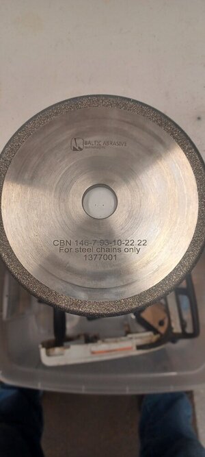

The good: sharpening 3/4” now is as easy and fast as 3/8, especially with the new Baltic 5/16” course wheel. 😃
The bad…the “slider” is a complete misnomer. The gauge shows +/- 20mm when in reality it can only move 5mm, front and back. Frankly, Oregon should be sued for false advertising, imo. 😡 Also, the chain stop that came with it is for smaller chain, sigh… I had to cut it down 3/8” to be able to even sharpen the 3/4” chain…much less do rakers.
The not as bad…that 5mm seems to be enough for what I needed to do.
But, it is absolutely nothing like the slider on the USG, not even in the same ballpark. Sorry, Oregon…you farked up there.
Fortunately, for me, it won’t matter. Others, who are expecting something like the USG…forget it.
But…. The thing was $500 rather than $2500-3500, so I guess I can’t complain too much. It will pay for itself in 6mos.
I have ordered the “jaws” kit for smaller chains for $30 so it will eventually replace the Vervor as a main raker grinder. I really don’t have room for 3 machines.

So they make Oregon 530 now??

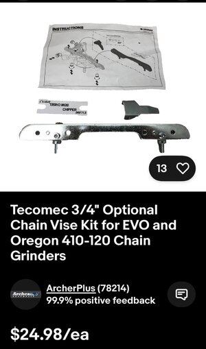

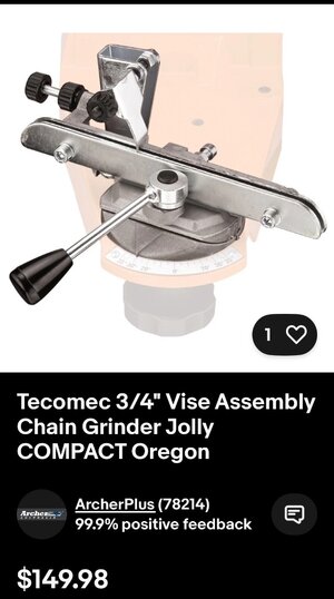

They always had a model for 3/4” chain.
Or, you could buy the vise assembly and swap it out on one of their standard grinders.
I suppose if you only did a few 3/4” chains, you could just buy the vise and go back-and-forth. But that could get old quick!
EDIT: Of course, if you already had a second grinder, this could be a good option to consider.

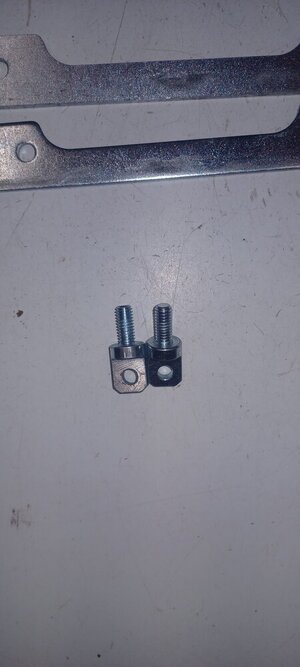

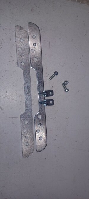

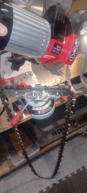

Got the 520 jaws kit today.
However, the only parts that are different are the 2 posts. That's all I actually needed 🙄
The jaws are the same ones that came on the grinder.
At least I can now use it as a raker grinder when not doing 3/4" which was my goal 😁
It replaces the Vevor that was doing that duty. The Vevor is now for sale :p
The smaller posts I got work great for 3/8 and 404, including the .080 18x Processor chain. This setup, however, is not great with the small 3/8 LP, especially. 043g. I haven't tried 1/4" but know it won't work :p
Smaller guage posts are needed for this little stuff.
I'll probably order another pair of posts and grind them down.
