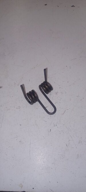

Freebie...well, will cost a few$ in shipping :p
Main spring for Ore 520 grinder.
It may fit others, don't know.
I no longer have the grinder and found this the other day.
Any idea how long these springs last under normal use? I ask since you had a spare.
cuttin
10:03 AM
32635
Apr 22, 2025
13
35
Oregon
The current models have a completely different spring system…hmm…🙄
I bought my Oregon 520 in July 2025. I just looked at the spring on mine and it's the new style. *phew!* The new style is much heavier with seven coils and arm pivots off tail end of spring.
