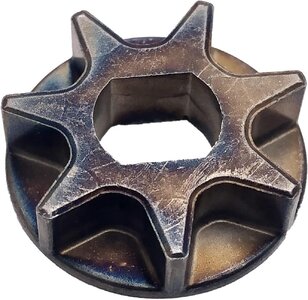

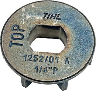

I bought a 0.050 1/4 bar to replace the the 0.043 1/4 rollomatic mini on an affordable stihl battery saw as I can not deal with sharpening the miniature 71 picco micro 3 chain. I see the drivers on Carlton E1MC-BL chain are ever so slightly different from those on the miniature Stihl chain. Attached is the sprocket used on these battery saws, a 7 tooth sprocket the size of a thumbnail,
1252 642 1201.

Although the pitch is the same, the chassis height is different and will require a different sprocket to fit each chain correctly, much like the difference between 3/8" pitch chain and 3/8" Lo Pro or Picco.
1/4" .050 top, Picco bottom
I don't have 1/4" sprockets to compare but here is the difference between 3/8 and 3/8 LP or Picco

no. it will cause early breakage.

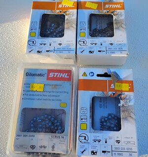

Here are (4) 56 link 1/4 .050 gauge chains.
