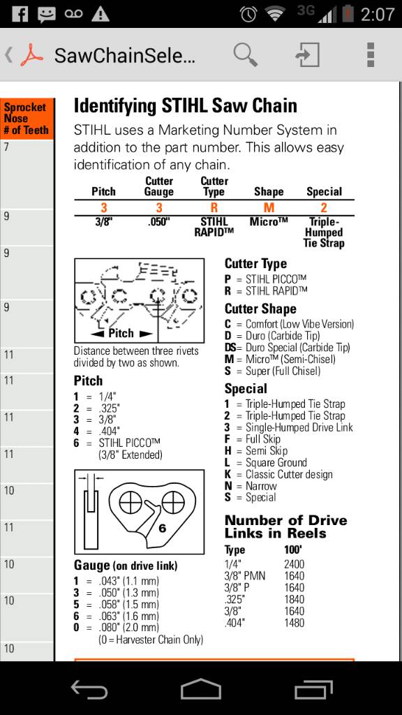

They dropped the C part for the comfort chassis as all is,supposed to be the same chassis now.
Yes, they do their best to confuse their costumers - likely part of the same plan (as the deception plan).
Reusing an old designation didn't make any sense when it happened, but now I see why they did it (at least I think so).

RSK was only .050" full comp.
