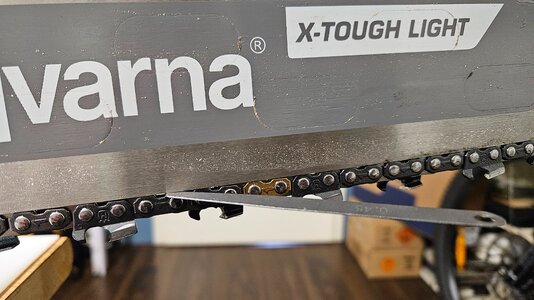

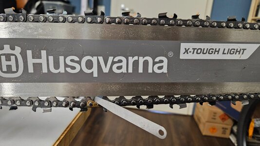

Hi all, i'm new here and I stumbled across this thread.
I observed this exactly behavior on my 550xpII buyed last year brand new with 18" bar and .325 chain SP33G.
It got better after cutting of some logs. Now last month i got another new saw 572XP with 24" light bar and with 3/8 C85 chain
and here the chain's behavior is even worse. I haven't used the saw yet, maybe next month, i'll see how it goes.
Maybe needs the sprocket and chain some run-in time ?

WTH is going on? Never seen this. New equipment should not be defective. I would return it
Bjorn
7:11 AM
9887
Jul 5, 2019
438
2,015
Sweden
I wouldent worry so mutch. Just run it for a day, then check if it still slacking. Usually the problem Will disapere.
legdelimber
10:11 AM
8391
Jan 14, 2019
853
2,172
N.C.
Are you thinking of flush cutting a couple of dusty stumps to burnish it in? :D
Bjorn
7:11 AM
9887
Jul 5, 2019
438
2,015
Sweden
Not really. But like many other stuff, a break in period. I have had same problem like this, I just run one tank of fuel. When cutting wood. Problem solve.
