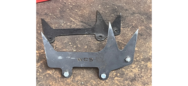

I inquired about the dogs because oversized dogs have the effect of making a chain seem overly aggressive. To the point that a lightweight saw can get sucked into the dogs easily and bog

those are the ones! I use the shorty version though because the bark here isn’t as think as out west!
I have Egan dogs, which are about the same length as WCS Shorties. And I took an inch off the end of the Egan dogs. Put your stock dogs back on and try it and you’ll see the difference.
Long dogs force you to run non-aggressive chains, which pretty much eliminates the possibility of a chain that feeds on its own. So you’re always forced to use them even in small wood
