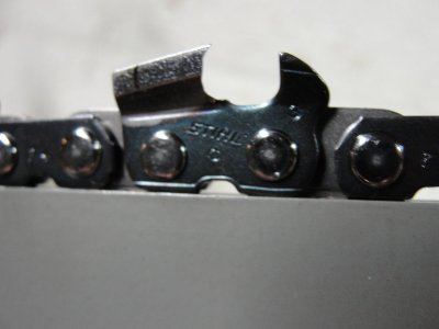

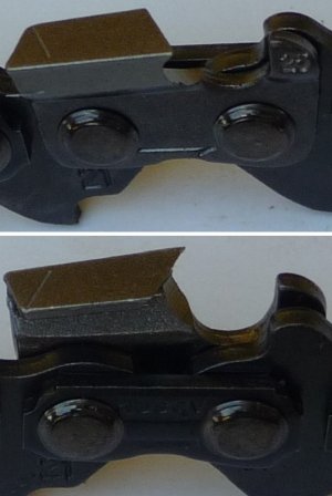

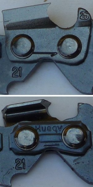

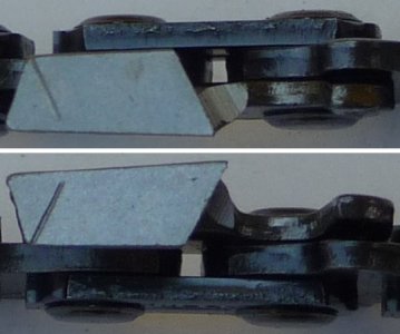

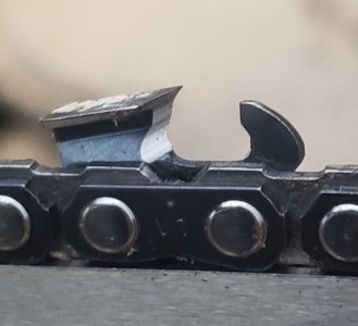

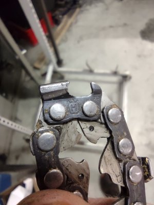

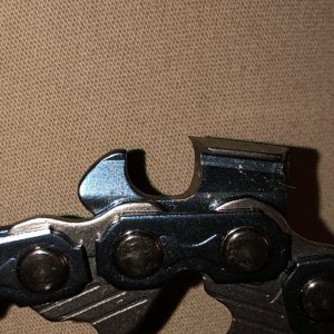

If I'm not mistaken about which is what, I disagree. EXL is pretty "blunt" with a pretty vertical hook and a big C shape. C83 has a pretty aggressive hook angle, and compound angle/shape with a vertical side cutter. Almost as if filed with a small diameter file. Stihl is similar.

Those are new unfiled chains? That’s not how I remember the Husky x-cut looking, I coulda swore it looked about identical to EXL but obviously that’s not the case.

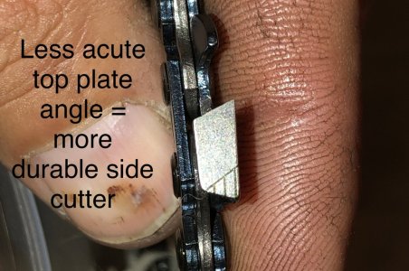

Yup. Got some xc to try and ain’t yet. Looks a lot like the stihl. The EXL I got from someone here and looks new but I was confused by the top plate angle not matching the witness mark.

it will last longer if you stay with the angle that its at. the witness mark is pretty steep it will cut good but you chain will last longer the other way.
