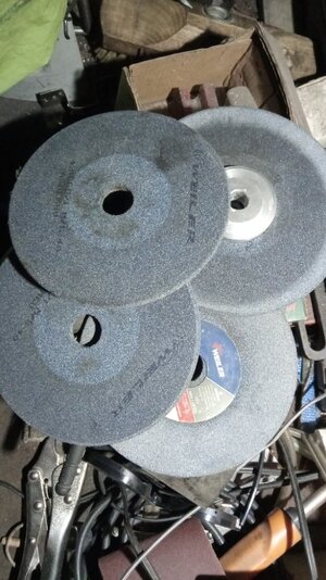

Maybe the diamond wheel is too fine for a chain that big.
Have You tried grinding with a coarse grit stone wheel?
I got these "used up" band saw Weiler wheels and made a contact plate to make them fit my AMA grinder.
They carry steel really well and do not seem to glaze like the pink wheels do.
These are being used "dry" grinding industrial band saws, as such I bet the make of the wheel is quite specific for grinding Speed Steel alloys.

‘Diamond’ brand sells both diamond abrasive, and CBN abrasive plated wheels. Causes a lot of confusion.
I LIKE your ‘repurposed’ wheels! Great to be / know a machinist who can take advantage of those opportunities!
