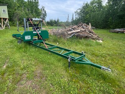

I have the 72” grandberg I was running a single 090 on but will be running 2 066’s on from now on when needed. Honestly my singe 066 wirh 3/8” wirh a 56” bar on my 48” mill does better for cut speed than my 075 or 090 with .404 ever did. The .404 holds up better in dirty wood ect and streached less but 3/8” is fine after the initial large amount of stretch is done. The 72” is a double end set up for 2 saws or one saw and a helper handle on other end. Most stuff my 56” bar on a 48” mill will take care of but I mostly use my woodland mills hm126 with the 14hp upgrade. Woodland mills are great and hard to beat for the money with excellent customer service. I bought the mill and made the trailer.

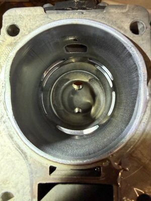

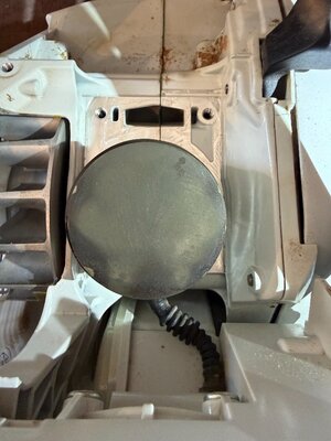

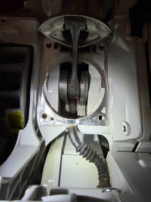

Here it is with a few tanks through it on FD rated Mystik "Lawn and Garden" at 32:1. I've been using this oil for years now, mostly at 40:1. I keep debating trying something new, but I just don't see a reason to. I've used Citgo 2 stroke oil for 25 years now. Mostly Sea and Snow in sleds and skis, when I was younger. I've burned up a handful of 2 strokes pushing the limit, but never an oil related failure. The oil film left behind is nice and viscous. Zero smoke once warmed, up, and only a puff at startup. Muffler is nice and clean, just dry ash, and no spooge. Exhaust port is still clean.
Wash pattern looks almost identical to my 661 mtronic that has dozens of hours milling. The 881 ran WOT for 10 minutes straight at a time milling this weekend, so its apparently safe. I turned it out against the limiter before I started, but it didn't even make 1/8 turn out, before stopping.
I have now pulled the limiters and gave it another 1/8 turn out. I'll see how it runs like that next time. Debating a base gasket delete. There is room on this saw to do that, and still end up with about .025" squish clearance. Will prob also weld on a WCS muffler port on the recoil side.
Overall, I'm very happy with the saw. Only negative other than cost is the vibes are a bit more than my 661, but it's not uncomfortable. It milled faster than I was expecting, and used significantly less fuel than expected. Had a bar tip failure, so that put a stop to finishing the log. Hope to get back at it next weekend. Cut up lots of 8/4 quarter sawn and rift sawn white oak, aka "white gold". Can't believe what the local mills get for that stuff.

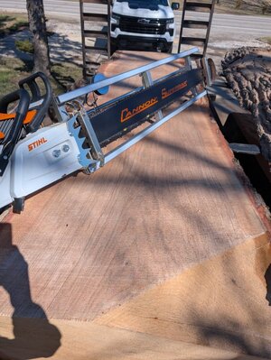

Had a chance to mill a few more slabs from the 48" white oak this weekend. .404 Stihl RS full comp chain ground to 20* top plate angle and 60* grinder angle. Still haven't touched the depth gauges. I may continue lowering the top plate angle to 15*. Haven't decided yet. On my 661 setup with 3/8 RM chain, 10* is too shallow, and slows the cut speed down quite a bit. I am very impressed by how many cuts I can get on this .404 before I have to sharpen it. Doesn't leave quite as smooth of a finish as the RM on the 661, but seems to stay sharper longer. I'm not sure how to explain that one, other than cutter size. I may try a loop of half or full skip...depends what I can get here before next weekend. The saw will pull the chain, but there are some times where it seems to either be bumping the rev limiter, or a bit low on RPM. Have to have just the right touch to find the sweet spot. Wish the CDI would allow a couple thousand more RPM. I feel like its best cutting performance is right near the limiter. Wood finish seems a bit better there too. I will say though, the speed that this mills over my 661 is very noticeable. I wasn't really sure what to expect...more power, but bigger cutters. Also this is wider than I've ever milled. At 32", my 661 setup through oak is very slow. I most likely will only use my 661 for milling small logs now.

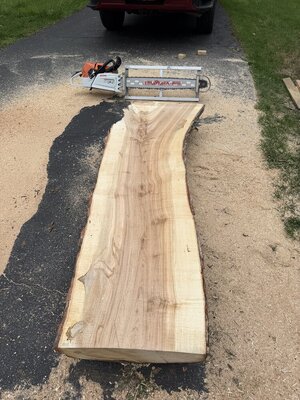

A buddy had some 25-28" soft maple logs that he wanted milled. Ordered a 36" Tsumura and it came with a "free" Archer .404 ripping chain (semi chisel sharpened at 10*). I've never used their chains before, but I was very impressed. I sharpened it to my specs before using, but it cut very well. I cut a few 6-8' logs without having to re-sharpen. The finish was very good, for a chainsaw mill. Sharpened to 55* grinder head angle and 15* top plate angle, with a couple swipes off of the depth gauges. Finish was much better than .404 full chisel chain produced, reinforcing what I found with 3/8 chain. I burned several gallons of fuel today, and continue to be impressed with the 881 on the mill. The upgraded oiler kept the chain wet and cool, with no aux oiling needed. Going to try some of this chain on my 50", when I get back to milling the large oak log.
