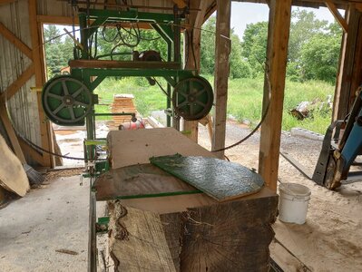

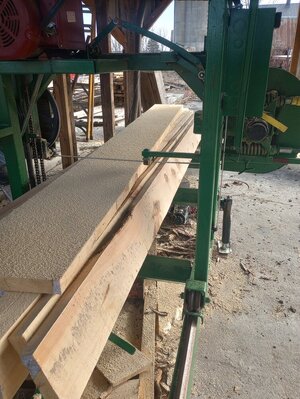

I have almost no experience with chainsaw milling due to having a band mill. Running two saws on one bar sounds like something feasible as long as you have a way to connect both throttles together.
I have a feeling that a carbide chain will wear out from stretching way before the teeth are shot. If you have the moolah to cough up for one, let us know how it goes.
Milling with an expensive chainsaw mill setup can get close enough to a cheap used band mill that I would seriously consider shopping for one. However, if you’re looking for something to cut 48”, that will take a lot of dough to get a band mill that big.
