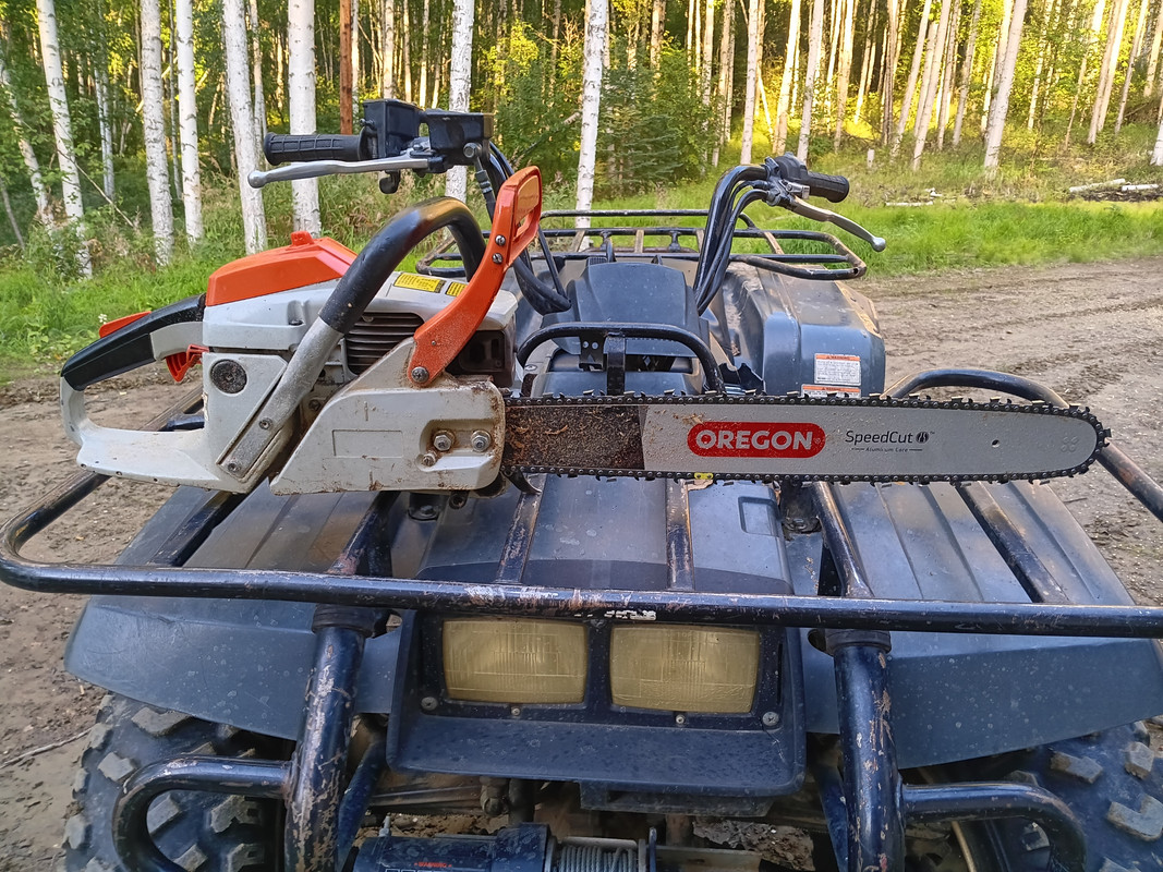

Holy sht does that 23rs pro cut GOOD!
Saw is a cs 520. Tunes up burblin rich at 14,200 rpm no-load and burble cleans up in the cut.
Saw is 11 lbs 4 oz dry powerhead only. 13 lbs 4 oz with the narrow kerf bar n chain.

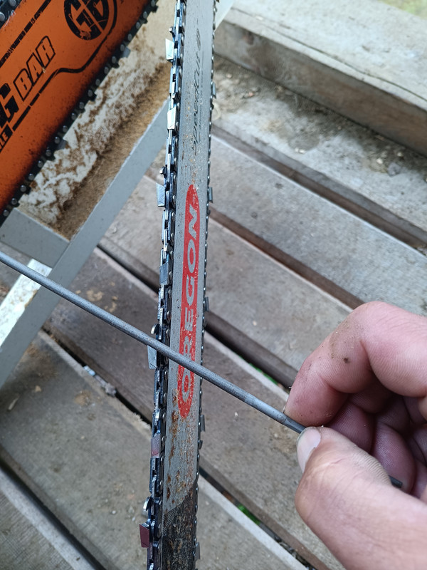

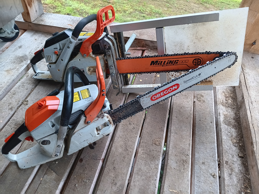

Im too new to 23rs pro to compare the two, but the cutters will easily take the same 5/32" file that i use on pmx 3/8 lp ripping chain.
Nice to be back in the 50 cc saws! Trying to get this btch-ass, frail 4910 to cut with a brick sht house cs 520 or cs 530. Gonna be a bit of grinding.
