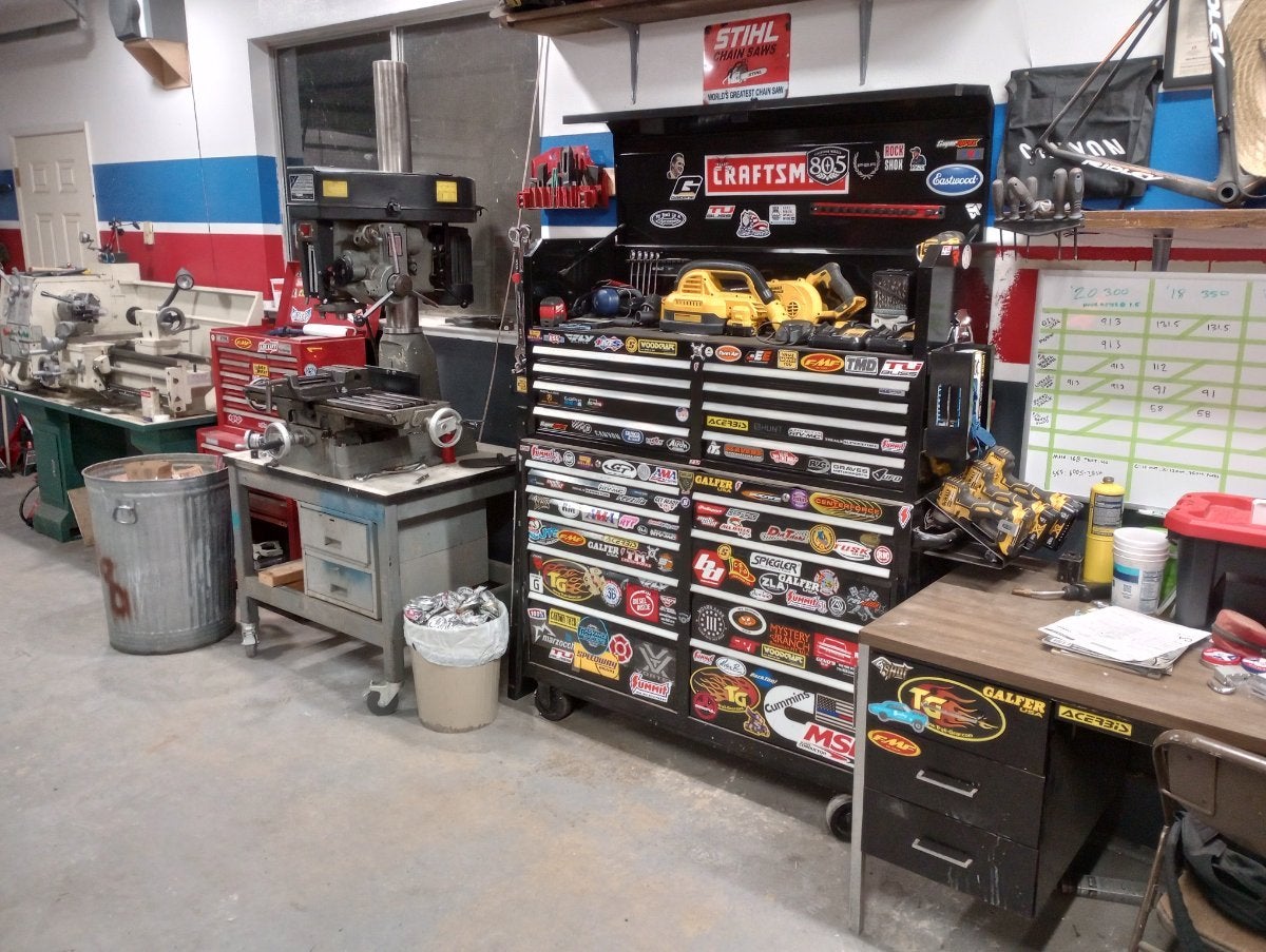

Not really "on the bench," but it was my shop project today...added a couple of canless LED lights above the lathe and mill. I like the results:

That's a nice set up...
