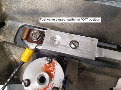

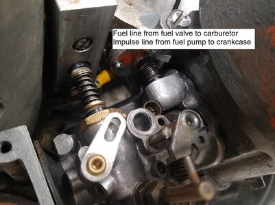

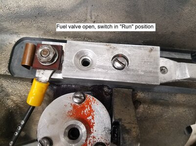

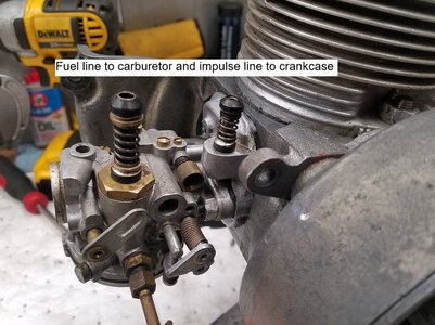

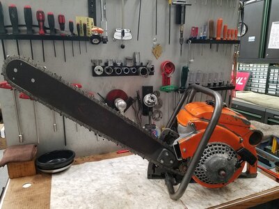

that's quite the setupI continued on the unidentified Disston today, interesting fuel and pulse set up.
The fuel valve and fuel pump are located on the bottom of the fuel tank. The fuel valve is a slider that doubles as the stop switch.
Mark

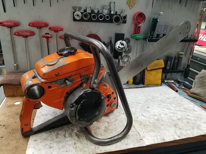

That saw cleaned up really nice!!It is much simpler than the DO-101 I worked on last week.
That bar has an almost belligerent angle to it…It is much simpler than the DO-101 I worked on last week.
I have a chain soaking, hopefully it will clean up O.K. and I can finish this one tomorrow. Has spark...fuel tank is crusty and the metering diaphragm is stiff so that will be it for now.
Mark
Or…lol…That bar has an almost belligerent angle to it…

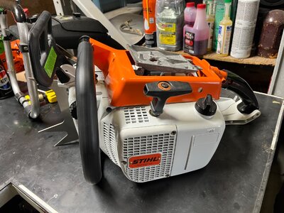

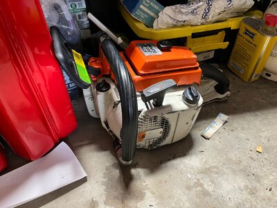

Good luck with the 076! I worked on an 075 and it wasn't until I was replacing the oil seals that I realized that someone did a mod and modded a 051 chassis to work with the 076 equipment. The 051 has two different sized oil seals and I couldn't figure out why the 075 oil seals would not fit, plus there are two different throttle linkages for the 075 and I needed the longer one which is NLA and nowhere to be found, all of the ones for sale are the shorter version. I ended up having to make a new one from a bicycle spoke. I also had to re-timesert the cylinder studs, they were all wiggly like a 6-year olds front teeth...what a pain that saw was!!Next project to start on, NOS 076 super and baby bro 041 super
Hey, that 041 actually looks usedNext project to start on, NOS 076 super and baby bro 041 super
I’ll try to make it look gently used when doneHey, that 041 actually looks used![]()
