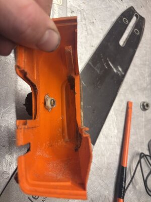

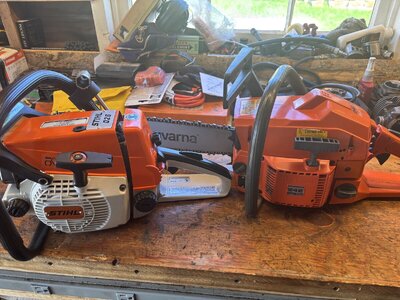

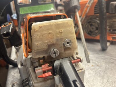

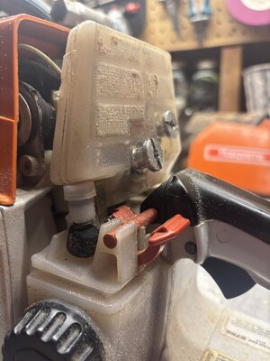

I gained 1500+ rpms in the cut by switching from a stock flocked 026 filter to a fine mesh 260 pro filter. I had to modify my top cover, swap for an echo tank vent, swap and modify the bolts, and plug the intellicarb hole in the filter. Ported, but still meh imo. I’d rather use my 242xp with the it’s rare KS cylinder pushing 200psi stock.
View attachment 474382View attachment 474383View attachment 474384View attachment 474385
Dang. Gotta get a 242xp now.
