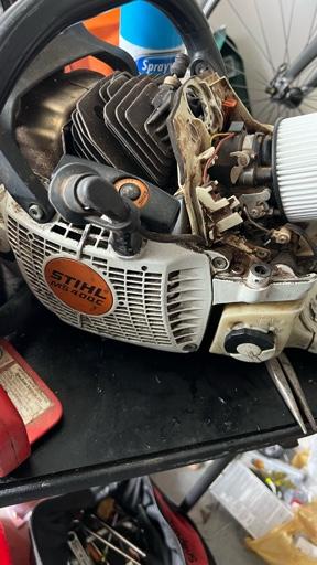

I snagged this yesterday. Story was it needed a carb and I thought that was a stretch knowing how new these are to the market. Turns out the spark plug threads are stripped. Can anyone help with the Helicoil kit I need for the NGK CMR6H size spark plug? I tried to figure it out on the NGK website and the rest of the internets, but I’ve never owned a saw with this little thread plug. Thanks fellas!

I take it that saw uses the 10mm plug threads? If so, it might be worth having the hole redrilled & tapped for 14mm.

I believe the thread engagement on 10MM plugs is longer. So the 14MM plug wouldn’t protrude into the combustion chamber. Regardless, I don’t think a helicoil is going to last. I would send it to Shaun Carr and have it welded and re-tapped.
But I’d probably try and secure the plug in it the way it is and try getting it running first so you’re not throwing money into a saw that may have multiple other issues
I wish that were an option. It’s like throwing a hotdog down a hallway it’s so stripped.

10mmx1.0 helicoil works well. The threads are fine enough the OD of the coil is smaller than the sealing washer.

Thanks man! I had to at least try a helicoil. Being fully aware they are not ideal for a chainsaw spark plug application all the time. If it doesn’t work I’ll just rebuild it and sell.
