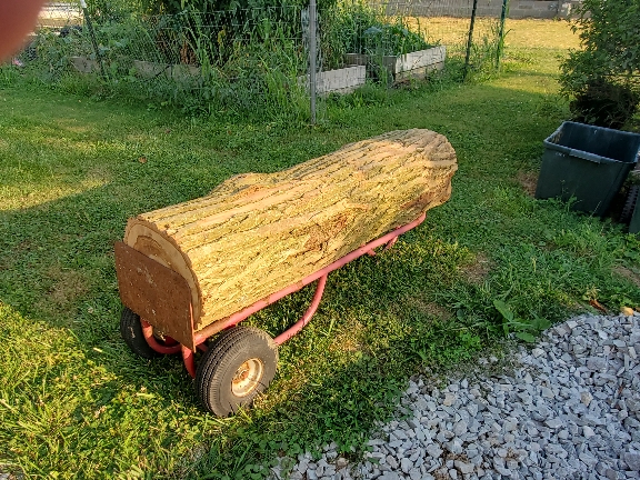

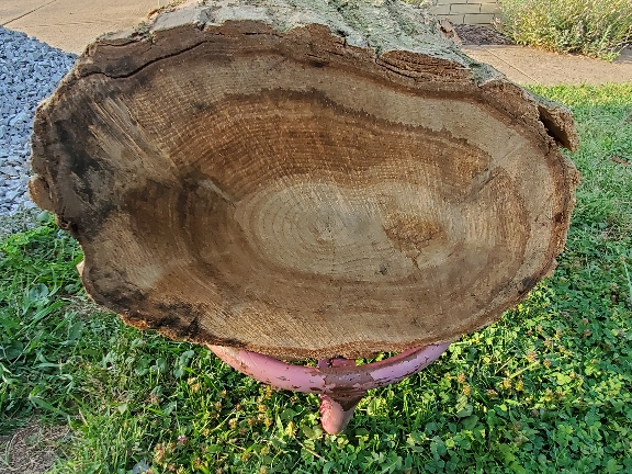

Anyone ever mill Chinese Chestnut? Cut one yesterday and brought a 4' chunk home to mill. Wonder what it looks like inside?

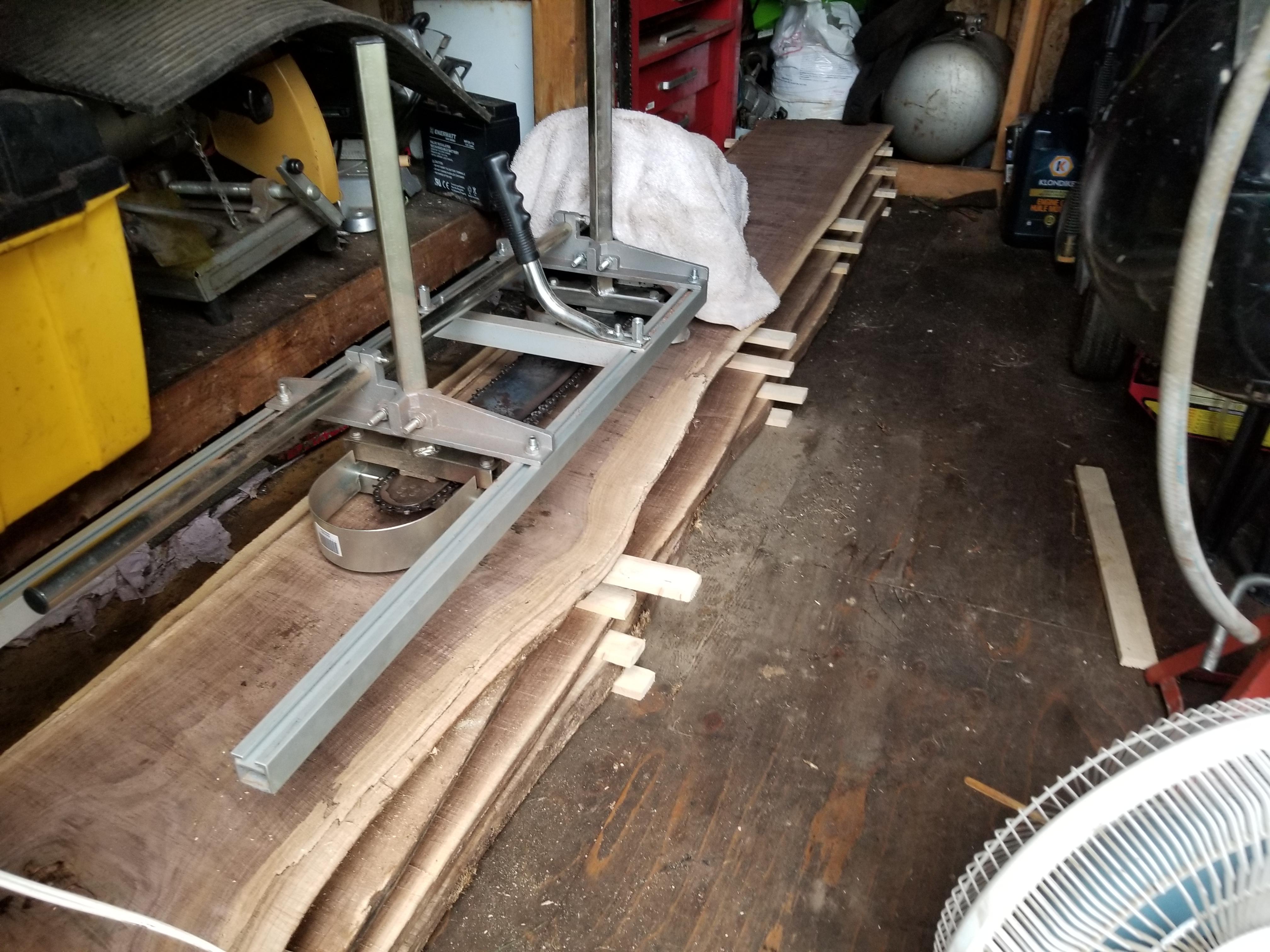

Made some slats to get my wood drying. Got one more log to do sometime. Was thinking about puting a few rachet straps arpund the pile when i get the other log done to help incase they want to twist. Anyone ever do that?
Yes, it works well. Did that with the posts and beams we used for my cabin (6.5 X 6.5 Ash 12' to 27' long).
Yep, straps work, just keep retightening.
