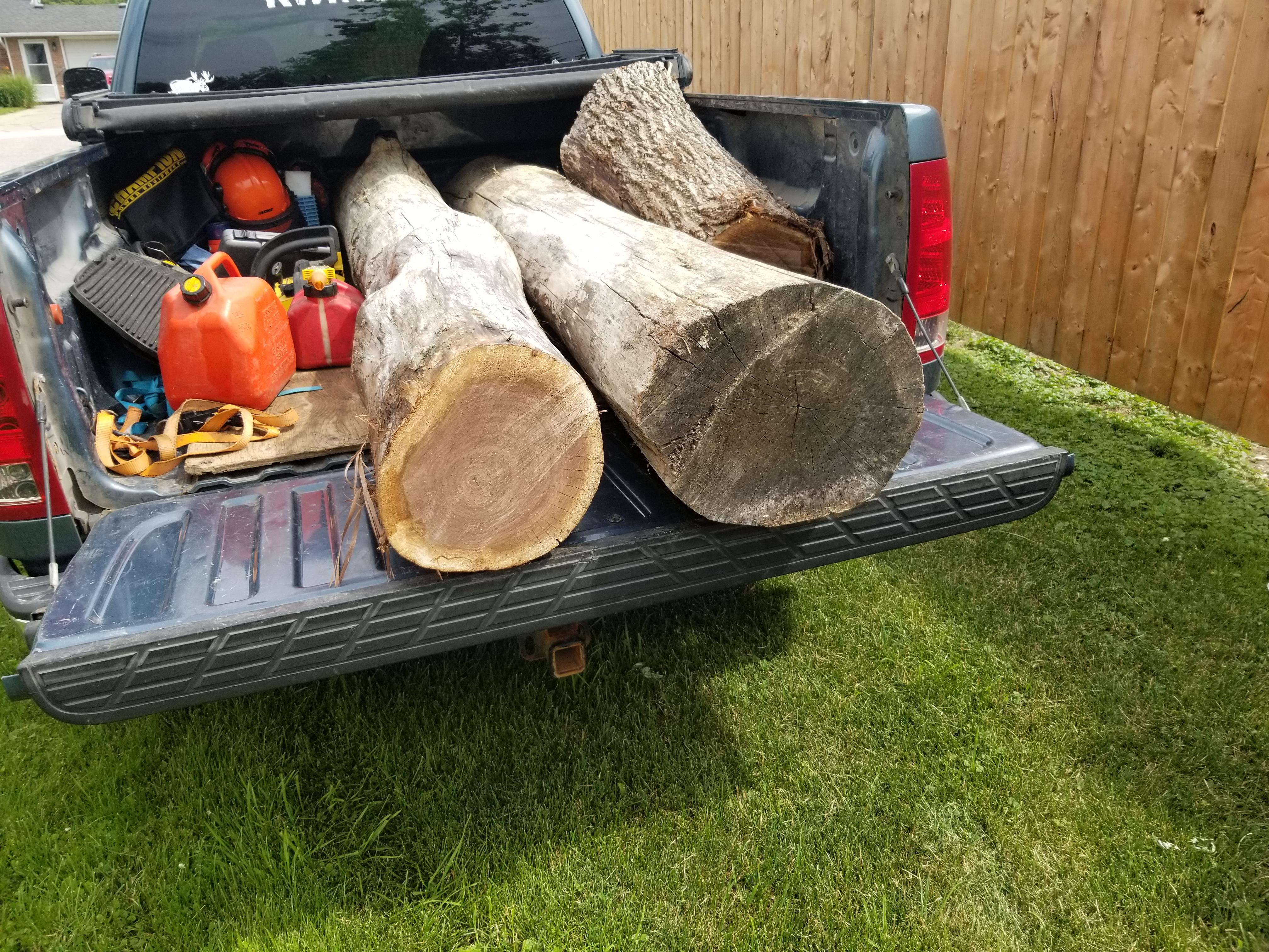

Got a couple logs to play with. Cant wait to get at them, been wanting to get the mill out again. Been a while.
