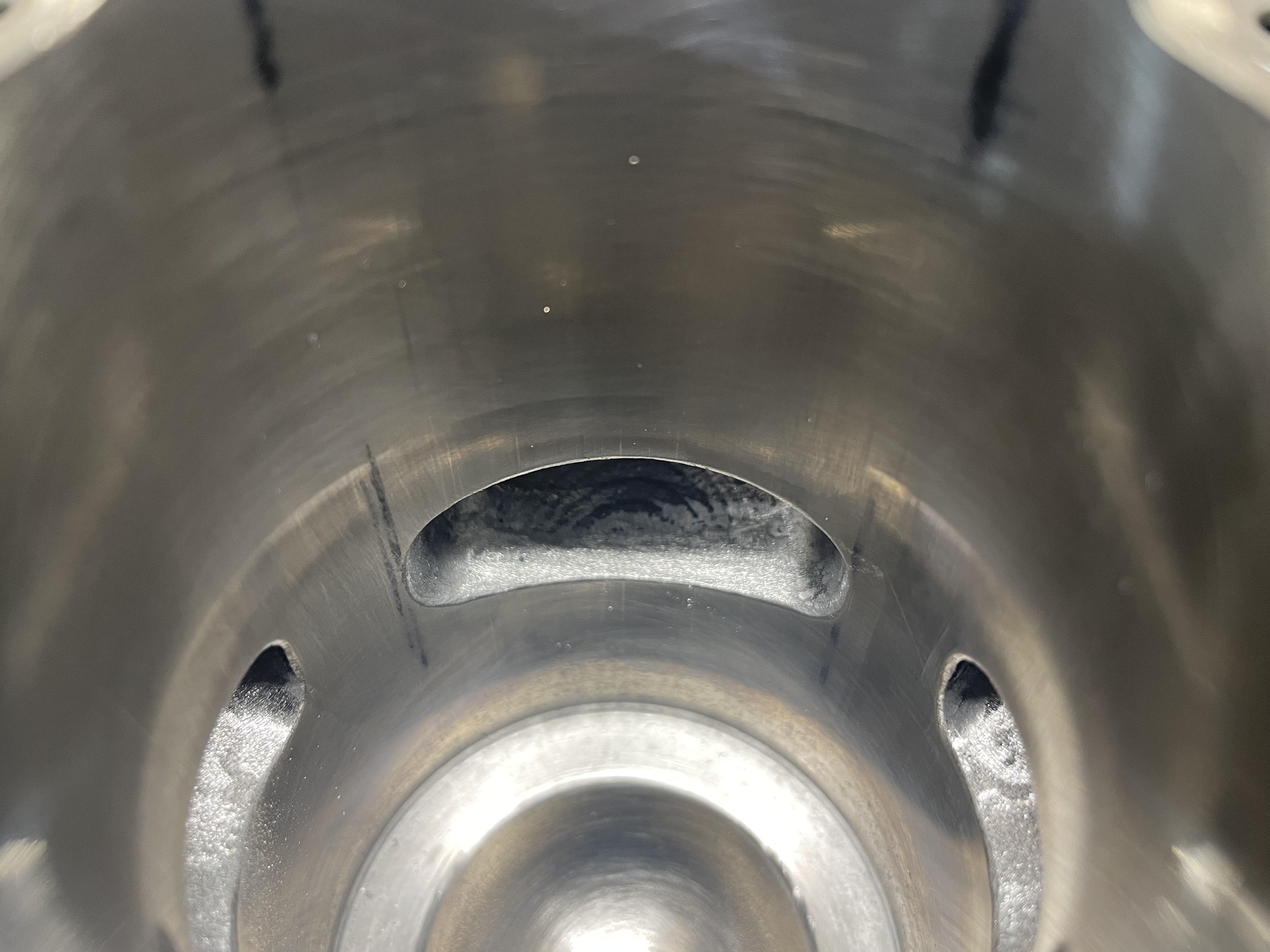

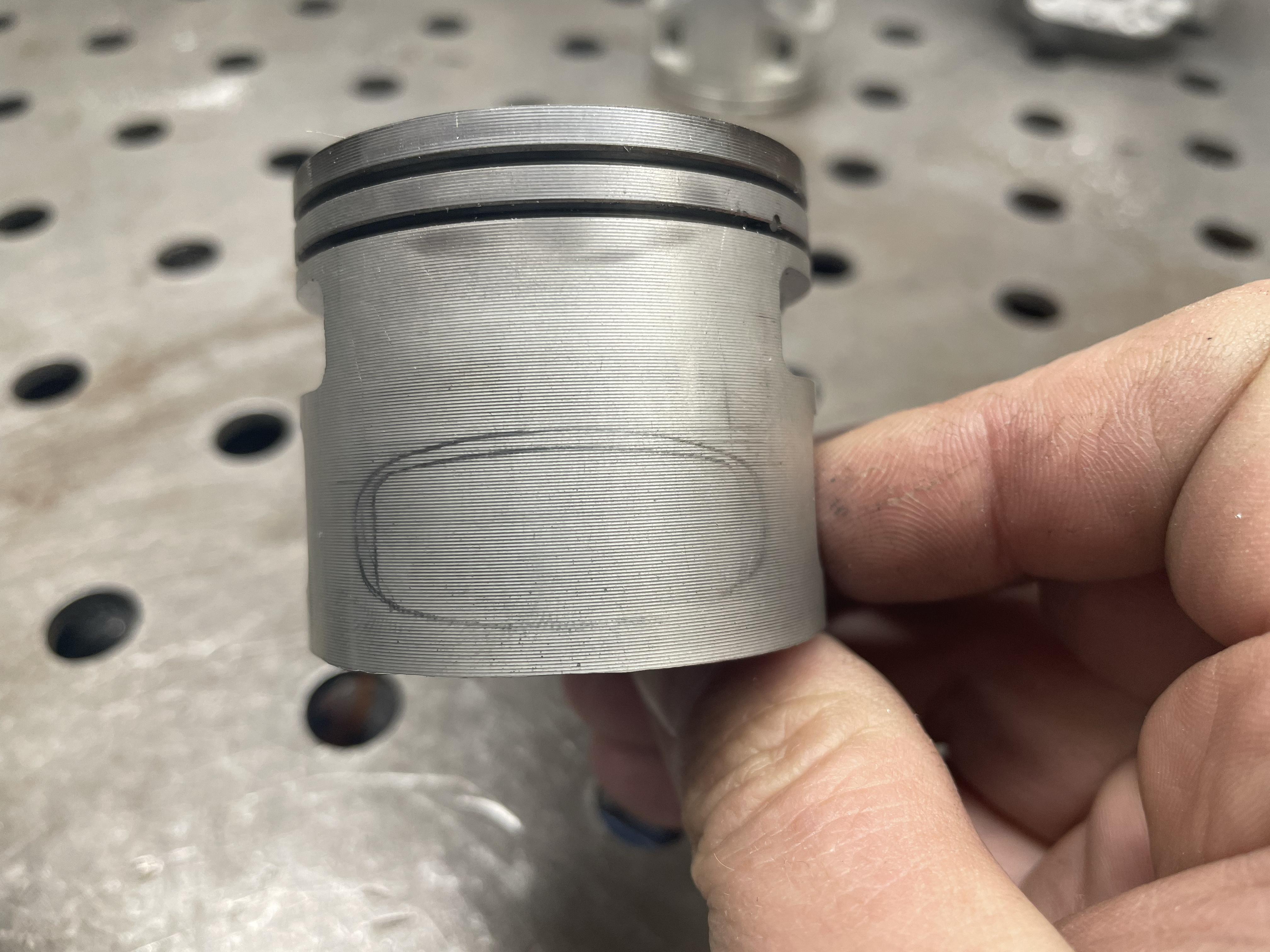

Some pics of the 585 porting.
The exhaust port grew a fair amount. I use a mechanical pencil to trace the port onto the piston so I can validate the shape.

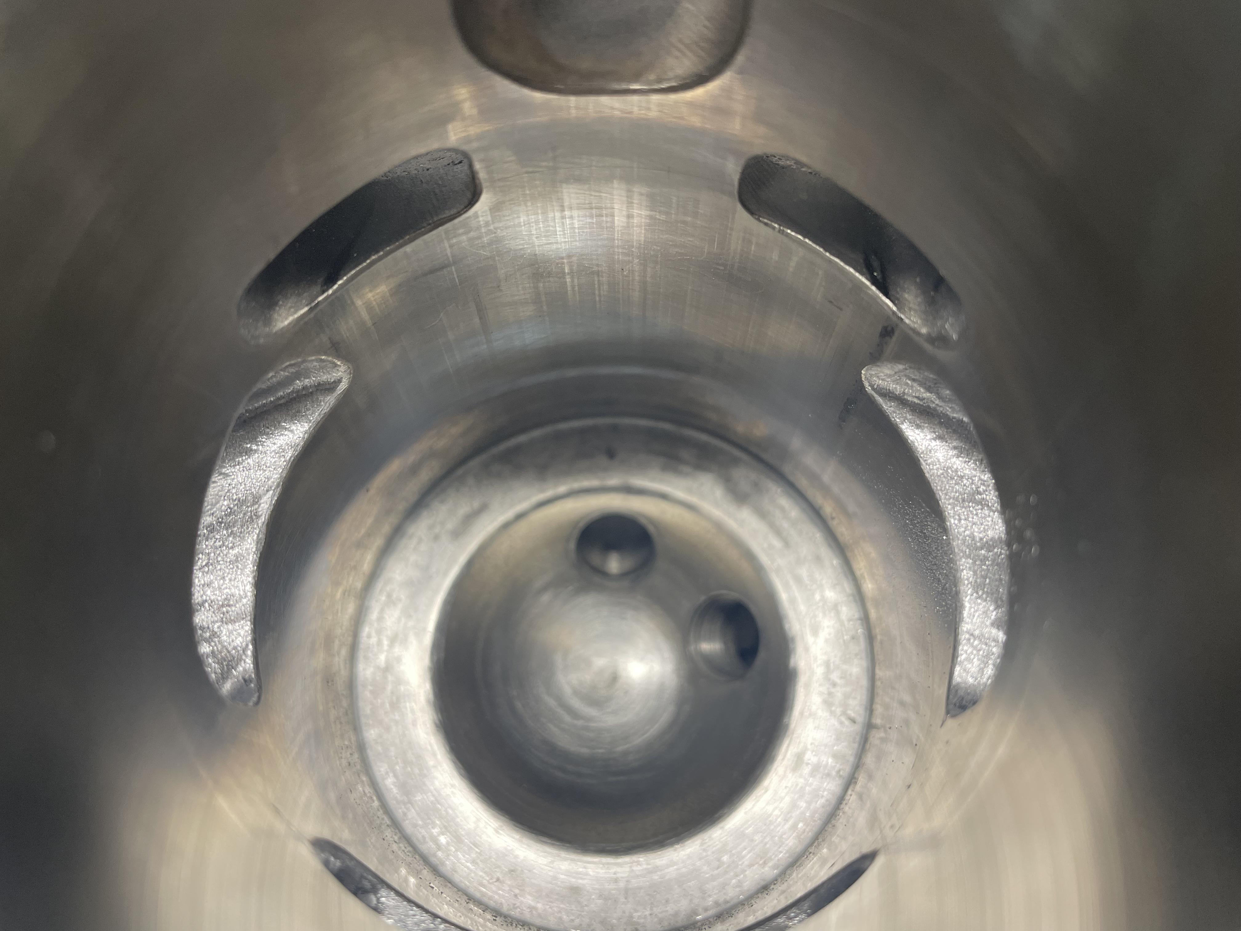

Comparing the cylinder, again 585 on the left.
All the ports look of similar shape and size (ratio to bore). The transfer lowers are pretty much identical, of course the bores are different sizes but so are the skirt extensions. So the 585 skirt extension is floating around in the case. Both exhaust ports have an identical wave pattern in the roof. The 585 intake port is rough cast while the 592 port is smooth like it's been machined. You can see the stock squish measured at 0.023" and 0.022".
