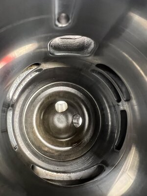

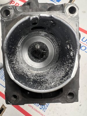

This is only the 2nd 400 I’ve done. To clear any confusion, this is the 50mm older version of the 400cm. It has a factory magnesium piston which I had been told would allow the piston to score with no deposits or damage to the jug. Many have since have called BS on that after working on scored ones. If anyone has a picture, please feel free to share.

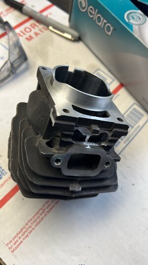

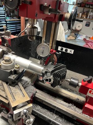

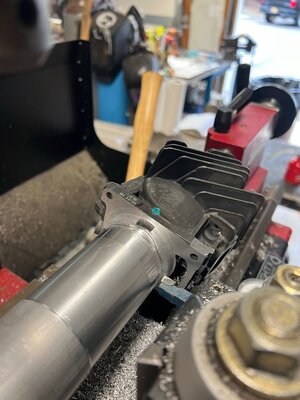

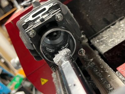

Disassembly time. Got the jug off and on the lathe fo a band cut. The jug is beautiful from the factory and a far cry from the “0” series cylinders.

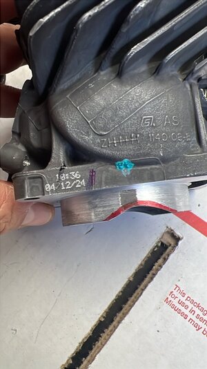

Is it normal that a jug on a new saw has got "used patina" (compare to the flywheel) - besides the color (or is it some sort of special surface treatment?) also scratches?!
They all look like this. I bet it’s oxidation after the casting. Good eye. This saw is 100% brand new.
This patina probably explains why different jugs look different. Mahle have this color. KS and Gillardoni are much brighter.

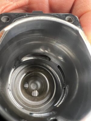

This is the jug. It has some other colored marks on it, and had a blue wax mark (not shown) on the PTO outer transfer.

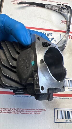

I stand corrected. I only see a Stihl brand marking cast on the jug. It does have the typical Mahle patina though.
Mahle are much easier to cut vs KS jugs. KS are a harder alloy and more commonly have plating that’s harder and extends into the ports, at least in my limited experience.
Here’s another wax mark. Must be some type of sign on the assembly line.
Maybe like the A, B coding back in the day? Curious how the jug date compares to manufacturer date on handle 🤔

Interesting use of a coaxial indicator, I usually think of it as a milling accessory.
