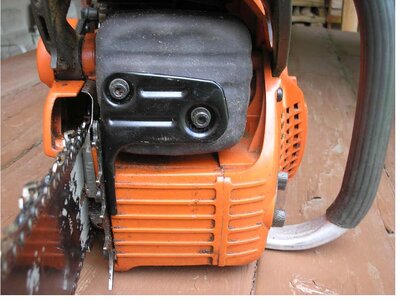

One of my favorite 350 mods using a part that I stole from a 353 and mounted on a 350 with muff mounts that kept loosening up. I cut off the right side leg that was not needed and rounded it off with a file. No loosening up after that.

Yep, I do that too!
