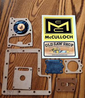

Hey Gang,
Thanks to Chance Would, I've got some new McCulloch 2 Man 5-49/1225 gasket and diaphragm kits available. This kit covers most of the 7-55 minus the Carb body gasket (still waiting to get one of those for replication).
Diaphragms are ready to bolt in and run....No rivets, No original diaphragm disassembly, or original diaphragm required.
Each kit includes 3 transmission shims (2x .015", and 1x .025").
Free shipping in the USA.
https://www.oldsawshop.com/McCulloch-Two-Man-Saw-kit-5-49-1225A-&-7-55-p740259124

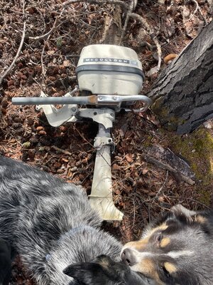

That looks to be the 4 HP air cooled outboard based on the 80 or 87 cc block. I think in reality there are very few parts that would work on a saw.
I just picked up this one last week.

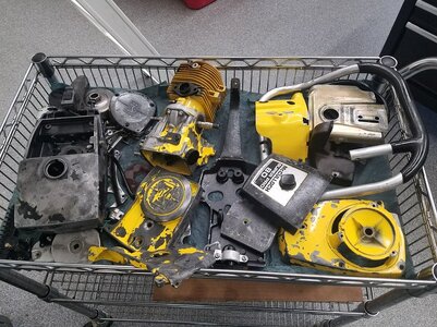

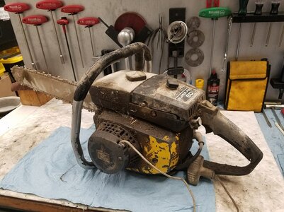

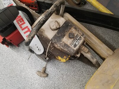

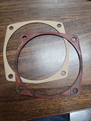

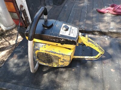

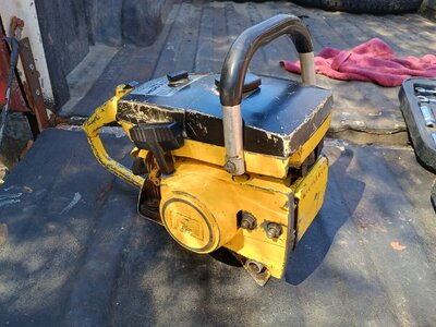

This one came in on Saturday. Guy said his uncle wanted it cleaned up and operational again.
Made it to the bench yesterday. Rather dirty inside and out.
Took a while but I got it cleaned up pretty well.
Failed pressure test so I had to pull it down further. This is an early SP80 equipped with thick rings and the bearing insert has a retaining ring rather than a dowel pin to position it.

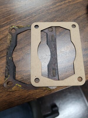

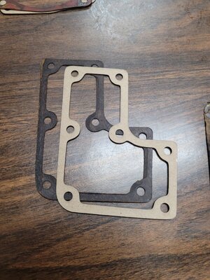

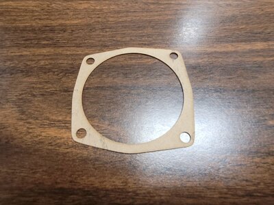

The piston and cylinder are in pretty good condition but the rings were questionable so I replaced them (PN 85245). The early 82 cc models have one large open transfer port on either side, later ones had a divider added.
PM 805 for reference.

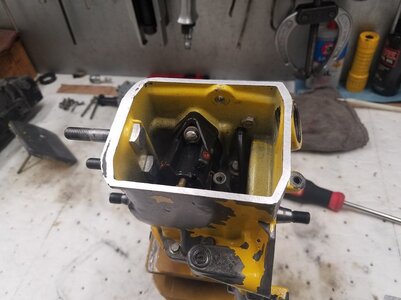

For whatever reason, the lip of the oil tanks on the 10 Series often suffer over time so I try to flatten them with emery cloth on a marble tile.
Going back together nicely.
