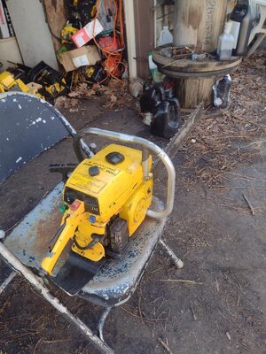

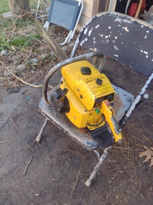

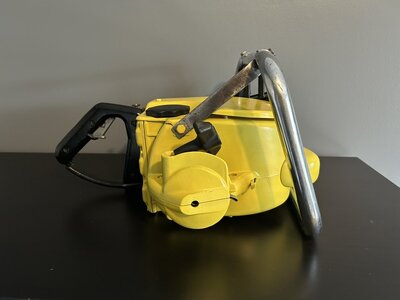

I finally picked up some kerosene yesterday & put that in the oil tank of the PM800.It puked out at the oil pad like it should,then I let it sit overnight with the kerosene in it & pumped it a few more times,then drained it.I mixed some kerosene with the bar oil & put that in,put a 24 in.bar & chain on & it seemes to be oiling as it should.The saw started on the 1st pull today,so all is good there.Here are a couple of pics.

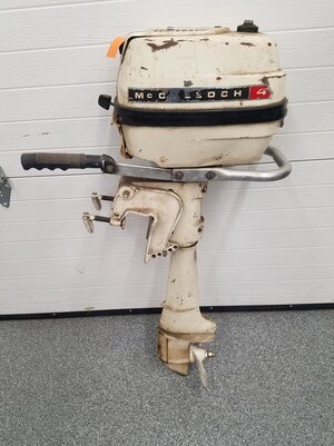

Mark @heimannm do you have one of these I've never heard or seen one until now.491348708_545046495305443_6959085196939805740_n.jpg
