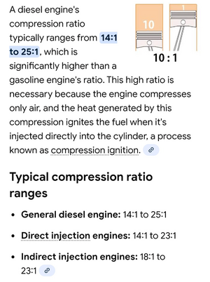

Wow google says the chevy diesel 5.7 was 22:1 compression
