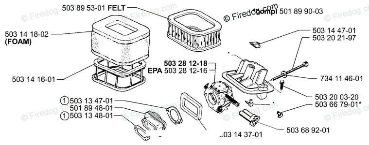

Factory foam filter and cage is a good upgrade to the stock felt filter.

Haven’t decided if I upgrade to OEM or just do a velocity stack on this one yet, any suggestions?
I have a 2100 and I put a velocity stack on it because I want it to breath....I don't want to be bearing down on it and it yelling back at me "I can't breath...I can't breath..."
Edit: Also the stripped threads and pop-top filter, chalk it up under some of the cost savings. For the savings, you can upgrade some parts and still have a quality saw!

I’m leaning towards the vstack as well. I know these huskies are supposed to filter pretty well as is but since it’s used for milling and the filter is away from the chips I figured it would be just fine. I have a feeling it’s going to have quite a bit of husky parts on it before long, I’d like to get the carb swapped and a 272xp coil and let er rip
