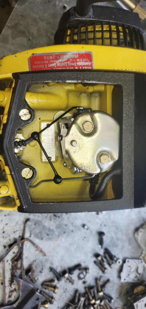

I think the aluminum used for the MDC carburetors must have been some highly active alloy as I have had many problems getting them to work correctly. I generally replace the check valve a routine part of service on those.
The other issue that can be difficult to deal with is the fuel "line" connection to the carburetor. There is a rubber fuel line fitting that presses through the tank exposing a short nipple on the side of the tank next to the carburetor. That nipple must engage the extended fuel inlet on the carburetor and form a leak proof seal. On older saws, particularly if they have been sitting empty, seem to dry out and shrink cause the fitting to leak.
I have had some success putting a couple of o-rings (007?) over the nipple before assembling the tank to the saw. It seems to help stretch it out and makes a tight seal when everything is assembled.
Working on the starter can be a bit of a challenge as the mechanism is buried down in there as you can see in the first photo.
I have also had some problems with the oil pick up hose leaking where it passes through the oil tank, since it allows some air gap, the pump won't pull oil from the tank. I had success with an o-ring there as well but I don't remember the size on that one.

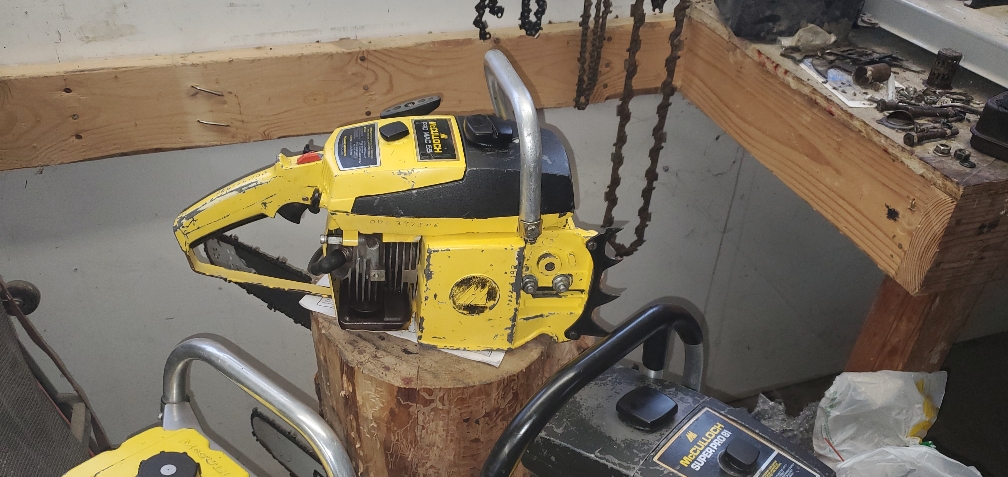

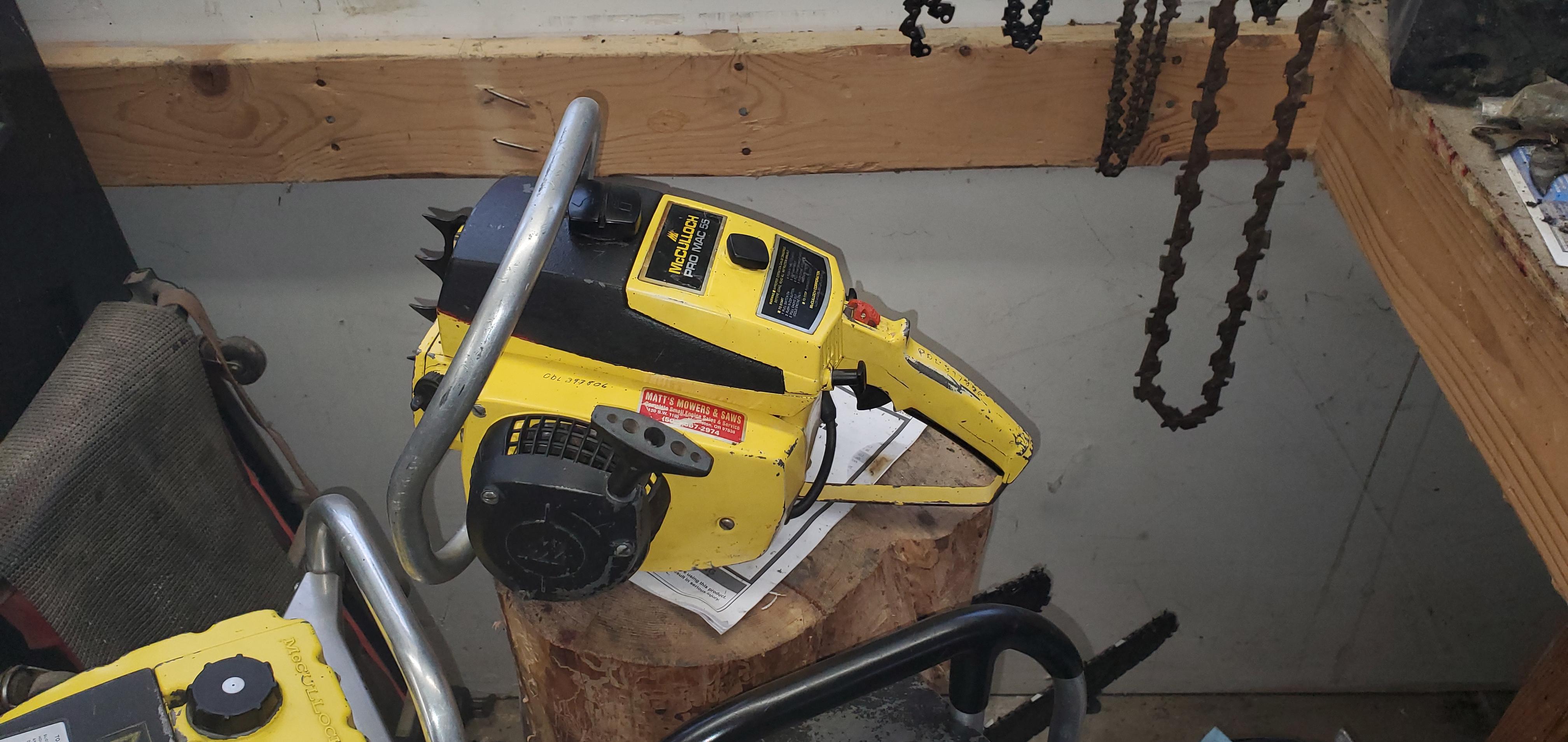

I got my PM55 yesterday.It seems to be in fairly good shape.The only thing missing were the bar plates,but I went through the saw rather quickly yesterday as I was pressed for time.Hopefully I'll have it running today.
edju1958
10:01 AM
6234
May 23, 2018
888
2,086
Western N.Y.
The PM55 is a runner! I needed to do a little work on it before I even could start the saw.The plug that was in it was the wrong one,so I put a new plug in it,the correct one.The oiler would only work intermittently,so I had to drain the oil out & pop the cover off the tank only to find the screen completely blocked with dirt,sawdust,& chips.Once that was cleaned & put back together it oiled great.That was by far the worst oil screen I've ever seen.I did put some fuel in it & within 8-10 pulls it fired right up,but loud as all hell.The PO must've though he was doing the saw a favor by taking the screen & cover off the muffler,it's like there's no muffler on it at all.Also,no boot for the adjusting needles
