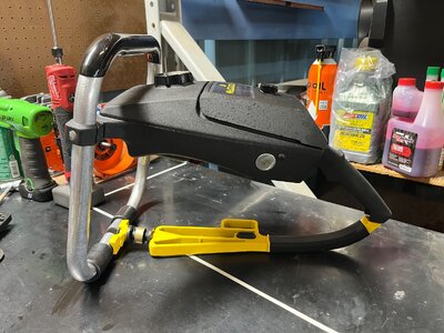

Hello. Finally got around to working on the S44A again. (Yeah, the one I started about 5 years ago)
Looking for two parts, and they do not have to be mint or NOS.
Part #'s are
51483 and 51561.
They are the grommets/boots for the throttle and choke rods. Parts listed as #8 and #9 on the parts list.
Was thinking of finding a place that could make new ones. The ones on my project are borderline trash.
I managed to find a reed valve for it, since the one I pulled off of it got lost somewhere in the mail. Sent it to Boyesen and checked with them, they never got it. Got the plastic type. Thicker than the original spring steel reed. Hopefully it works.
So it is currently on the bench getting cleaned up and I made some new gaskets.
