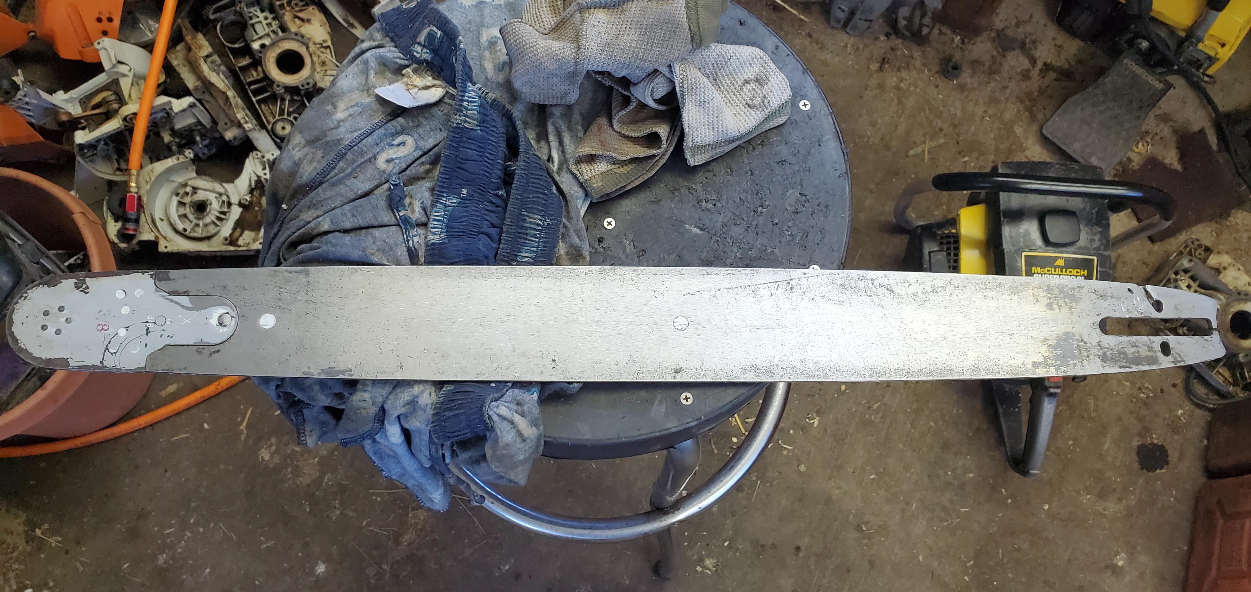

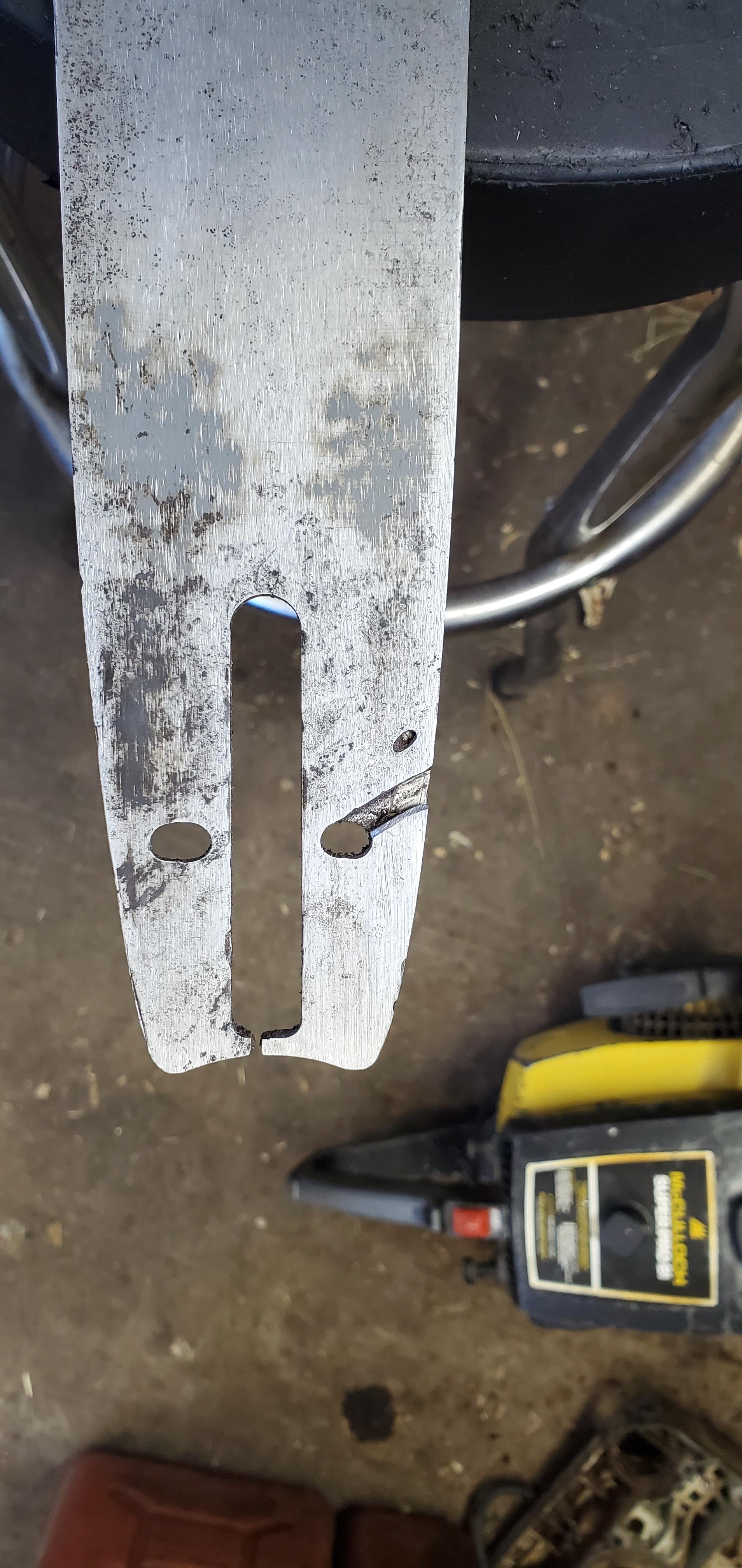

It's been super busy over here but I finally got around to doing a little saw stuff. Picked up a bar adapter so I could put a good 28" oregon bar on the sp81. Thanks for the suggestion maintenance supervisor! I made a quick alteration to the bar so the oil would feed in properly and the tensioner would fit. I'm curious as to how you fellas do it? I thought about taking a thin cutting wheel into the groove of the rail just above where the oil would normally feed in. So mimicing the function of thr original mcculloch bar. I ended up modifying it to mimic the function of some of the earlier Mac bars though. Should have looked closer because the back plate isn't quite flush with the bar, so I may lose a little oil here and there. It works though and the sp81 is rippin'. An overall good condition saw, everything works great. The Jethro spike adds a touch of class as well! Need to put a proper fuel line and grommet in there though, the 036 line I put in is a little too long and the fuel filter needs a weight on it.

I have used a thin cut off wheel to cut the bar groove deep enough to open into the elongated hole in the bar, that is the way the oil passes on the typical 10 Series bars. I have also drilled a couple of small holes through the bottom of the bar groove into the adjuster hole but I like the cut off wheel approach better.

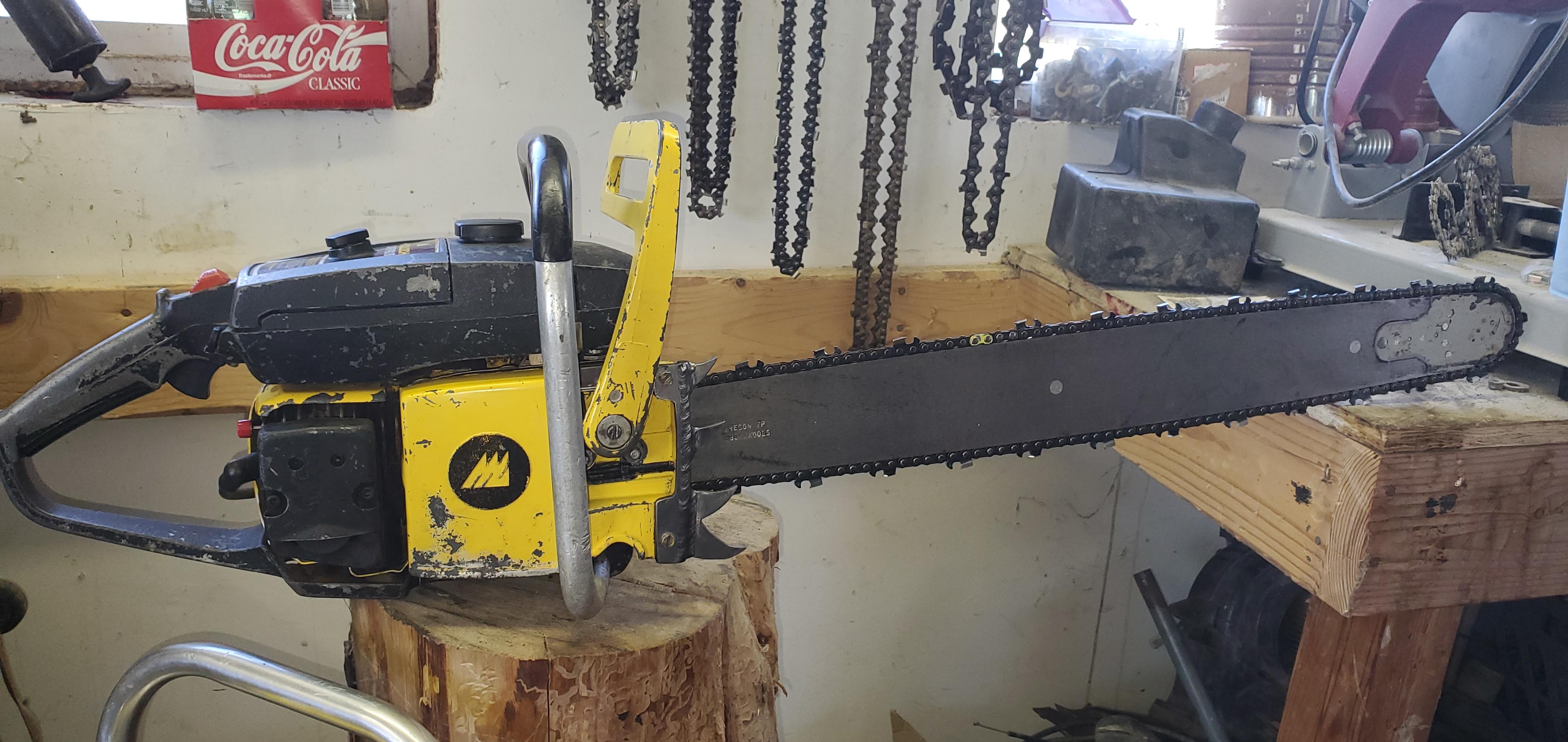

She's a runner now. This saws biggest problems were just mismaintenance the allen screw came out of the tank in the oiler ,3 screws were lose holding the tank/handle down , muffler bolts lose or missing.
The hole that intersects the bar plate to the oil passage was corroded shut and I had to use a hand drill with a mico bit to open it up , luckily it's self flushing with a few pumps of the manual oiler.
The lead coil wire had some "fixes" ,so I replaced it with a cleaned points coil , still running the points.
All in all it is a pretty common list of things you might encounter, fuel line and carburetor were relatively nice.20210621_105821.jpg 20210621_105808.jpg 20210621_105814.jpg

Really like the color pattern there with the black tank and yellow filter cover!

On those bar modifications I've used two thin die grinder cut off wheels mounted back to back .The little chainsaw grinding bits used on a Dremel type die grinder are handy to elongate the mounting/oil hole .Bar steel is pretty hard stuff .The only way I've found to actually drill a hole is with a solid carbide drill bit of which I have plenty .
I've said before within reason you can nearly adapt any bar to any saw .My avatar saw, a 2100S Homelite has a Stihl 066 mount 36" which it wears most times .The tail is a little too narrow with an 8 tooth .404 rim sprocket but so far hasn't caused me any problems .
