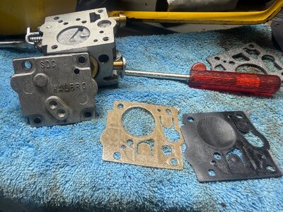

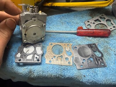

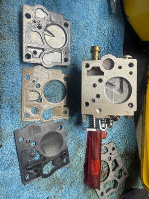

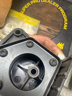

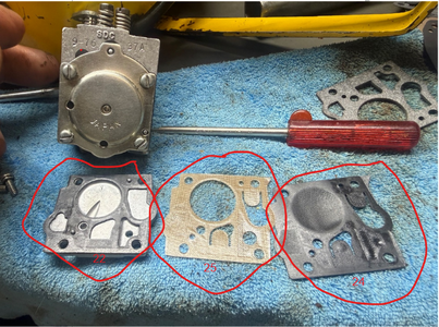

This is a walbro sdc
I’m trying to confirm if this is the correct layout of these diaphragms on this carb I opened it up to inspect possibly replace just want to confirm the order/ layout or if they’re is actually suppose to be 2 excluding gasket
Some of the markings are as follows
21-85
9-76
37a

A rule of thumb for carbs I didn't have a diagram for?
look at your diaphragms for the tabs/flaps and I'd go with the flaps touching the flat machined surface. The carb body here.
The gasket against the die cast cover that has the raised ridge line around the face.
Watch for any holes being blocked.
I'd wager that double stacked diaphragms would make it awfully hard to ever get the engine started, if at all.
Thinking that I'd leave out the tan one and try things. Maybe set the mix screws to about a turn and half out, for a starting point.
For what it's worth, I try to find the black rubber ones. To me those seem to make for the easiest starting. The textured ones seem to take a lot of fuel on them to make a seal and pump. I really don't care for the blue or black plastic (shiny) ones either.

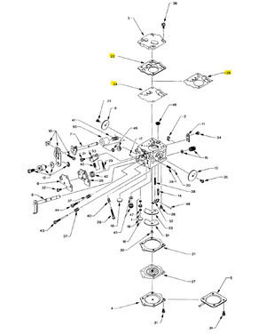

21-85
9-76
37a

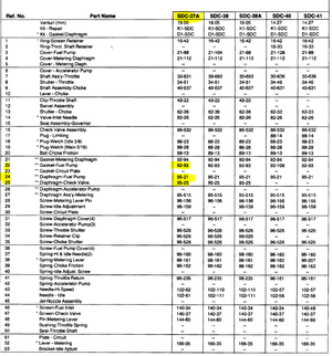

This is for your SDC 37A. Other models can use slightly different configurations.... I'll also post the complete IPL here if anyone wants to try to figure out other SDC models. it's just checking your model part numbers against the expanded diagram.... If you have two gaskets, the thicker fuel pump gasket (#22) is used with stamped steel cover, and the thinner gasket is used with cast aluminum cover.
