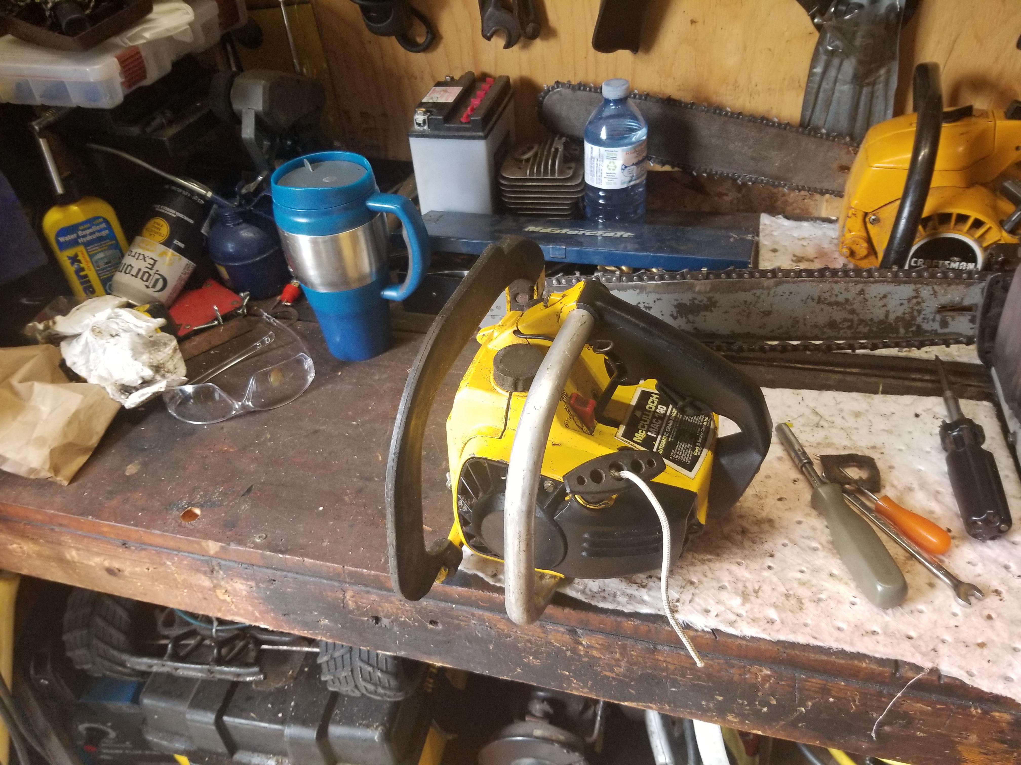

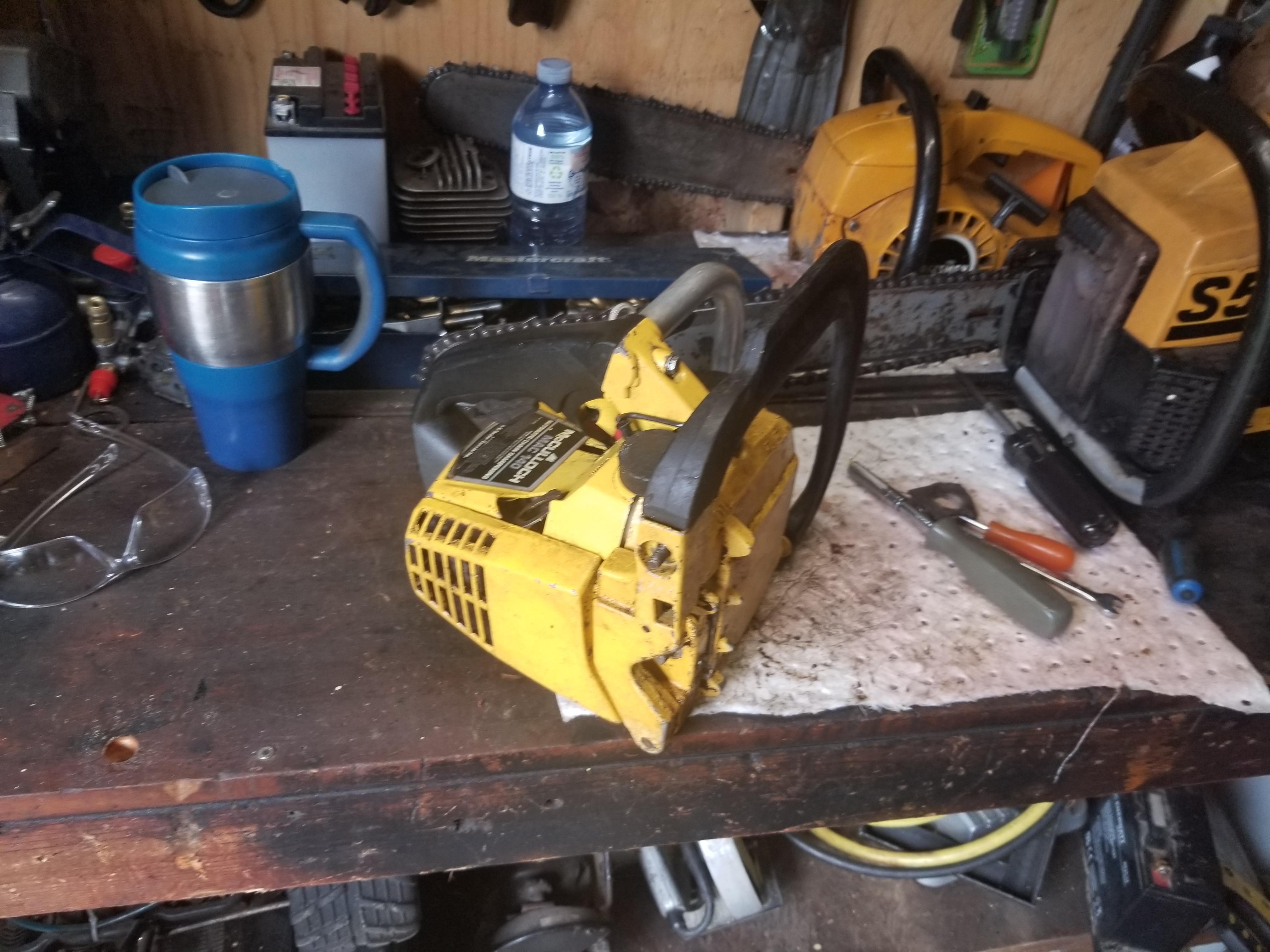

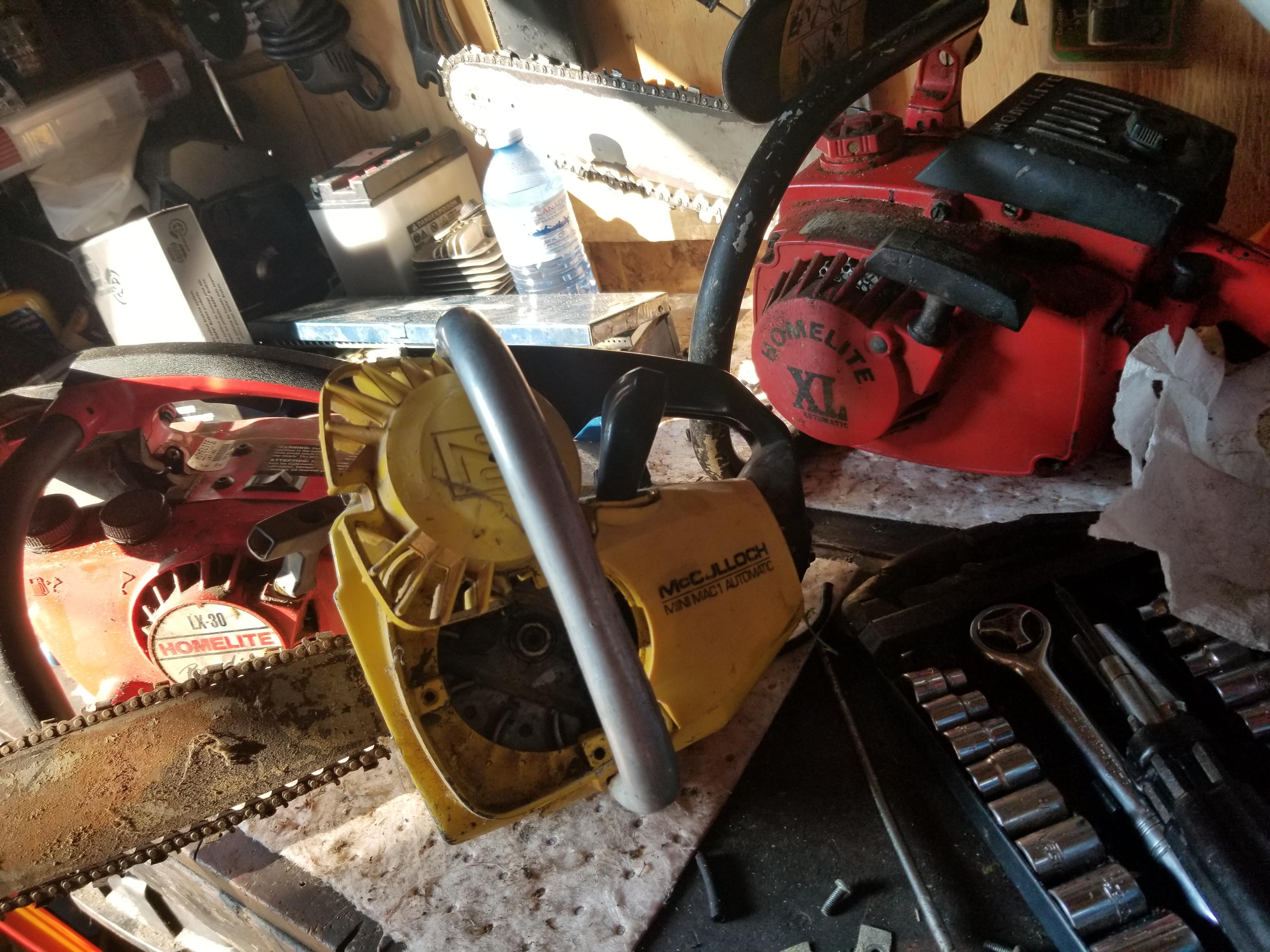

Got another mini mac finished up. Just need some fasteners and can see if she runs.

The MM6 models are the most challenging since the starter does not come out. You have to align the fins on the flywheel with the starter clutch as you slip the engine out of the housing. Enjoy.
Dream - too often leaking bar oil on the 600 Series saws is the oil tank to the crankcase, pretty major tear down to remove the oil tank and reseal it. Enjoy.
