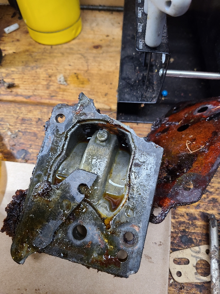

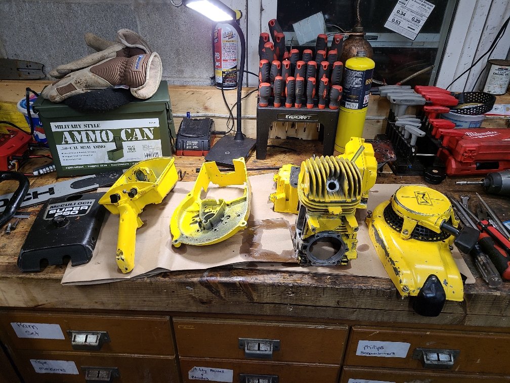

This afternoons project. I tore the Super 250 down completely. Going to go through it and rering and re seal it.
I managed to break the crank stuffer trying to get it off, bummer. I will have to see if one of my parts saws has one here that will interchange.
I asked before, but does anyone know where I can get the proper gasket material to make the reed plate gaskets? These are extremely thick, much thicker than any of the Karropak material I have here.

...anyone know where I can get the proper gasket material to make the reed plate gaskets? These are extremely thick,
How thick and how rigid? And what's 'proper'? The FelPro hybrid cork/rubber material comes in different thickness and is good stuff. Can be a challenge to cut the thicker variety to precise shapes without a steady (and patient) hand and a sharp X-Acto knife. The thinner stuff is much easier to deal with.
Or you could just double up on more conventional paper/light cardboard type material. A gently used 12-pak box comes to mind.

Just looked up that gasket. Couple on the bay right now. You'd need the thicker Fel-Pro or some fiber-type material for sure. Maybe some auto exhaust gasket material?

I used 1/16" karopack doubled up with loctite 518 on my 250. Has been holding well for 8 years now.

I've used these, and they work pretty good:
https://www.ebay.com/itm/VINTAGE-GO...KE-GASKET-CART-CHAIN-SAW-PART-X5/383704653620
Gotfishon43 is an ebay seller that makes a lot of gaskets for McCulloch but I don't see any intake gaskets in his store right now.
Autozone sells a thick, gray, high-temperature gasket paper that I've made intake gaskets from as well that works pretty good.

Cometic makes header gasket by the sheet. Oreillys, Autozone, etc.

I've ordered 10 series Mac gaskets from gotfishon but he doesn't have anything listed for the large frame saws. I have found the necessary gaskets on ebay by part number. Just exploring other (less expensive) options first.
Dido Steve, they have it at Napa, and I use motoseal instead, but same basic idea, I only use motoseal because I didn’t buy stock in GameStop in time....
I try to buy precut gaskets, but it ls fun to make some every once in a while...
Made this one when I did the kart Mac
This is what I got at Napa, the thin karropak is about .020 and the thick is .0554A119A09-5B50-48CD-A622-14392AB6C78E.jpeg

This usually takes care of whatever roll your own needs I may have except for exhaust gaskets. The thicker stuff is what I talk about using for 10 series tank gaskets. I just cut a strip from the edge of the sheet to the correct length (along with a little MotoSeal) and no more leak. And you can get a helluva lot o' tank gaskets out of a sheet. Pays for itself with the first one.

Mark is setting me up with the needed gaskets as well as the stuffer plate and rings. Thanks for all the advice. I will need to look into some of those thicker gasket materials. I have 1/8 cork, 1/8 Buna N rubber and a couple thicknesses of Karropak on hand, I would like to get some of that cork/rubber hybrid stuff.
