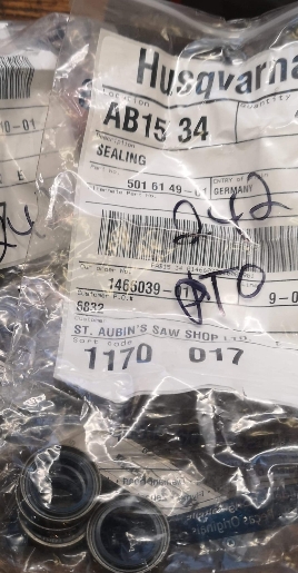

If anybody has the part number I'd be happy to look them up.... If they do work, I'll order some seals and send them out to you guys at no cost
501 61 49 01

If they do fit please report back, I think I've seen the OEM seals for sale somewhere.
Well I finally got around to popping a seal out of the @Duke Thieroff bearing to see if an oem seal will fit. Unfortunately, the oem seal has a smaller o.d. and smaller i.d. than the seal that came with the Duke's bearing, so the oem seal is a no-go in this situation.
Thanks for that!
Anyone who purchased the bearings please get ahold of me at the shop (number listed in signature) and we'll work out a way to get it right.
Thanks!

Anyone find a fix for the seals.
Ran a few tanks thru mine a couple weeks ago, she's a little beast.
Husqvarna still sells the seals for the pto side in Europe, but I haven't been able to find a seller that will ship them to Canada, USA. There is also a supplier in Sweden that is selling the complete bearing/seal for the pto side, but it is similar to the Duke bearing, and I don't know if it would actually hold pressure/vacuum. If the oem seals were available here, it would be easy enough to buy a cheap 44 (or 2 or 3) with known good bearings and swap out the bearings to your 242/246.
