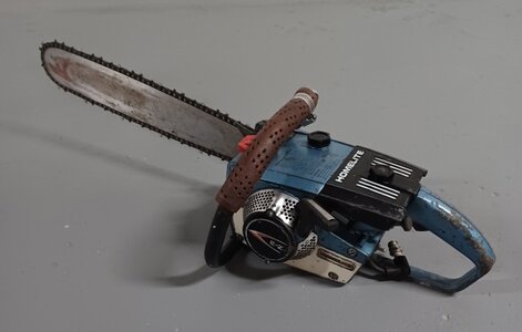

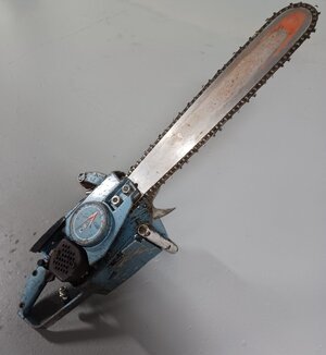

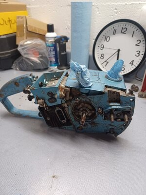

Hey troops . An old friend left this on my tailgate one afternoon with a bunch of other stuff he said was broken and he no longer wanted .
I have done no research on this and wondered if it's worth it to try to "mechanically restore" it.
If anyone wants to share stories / info / parts sources / etc , I'm all ears .
-Gene

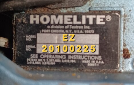

Those were tough, durable little saws and, in my experience, usually don't need much more than fuel lines, a carb kit, and possibly a point filing to breathe life back into them. That one looks pretty nice too. Used parts should be easy if you need them, Homelite made a b'jillion of those and the EZ super.

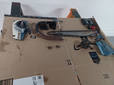

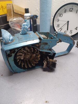

No scoring on the slug viewed through the exhaust port , just carbon . I would replace e all the fuel lines and rebuild the carb .
I need to build a flywheel puller next .
Here's where I'm at.
