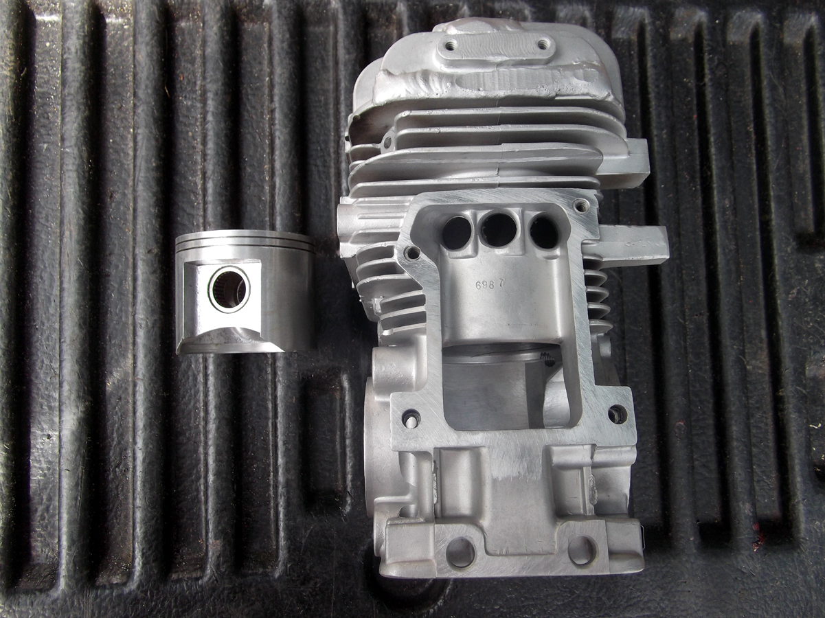

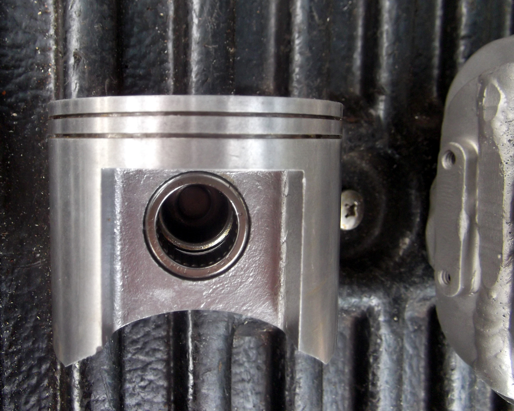

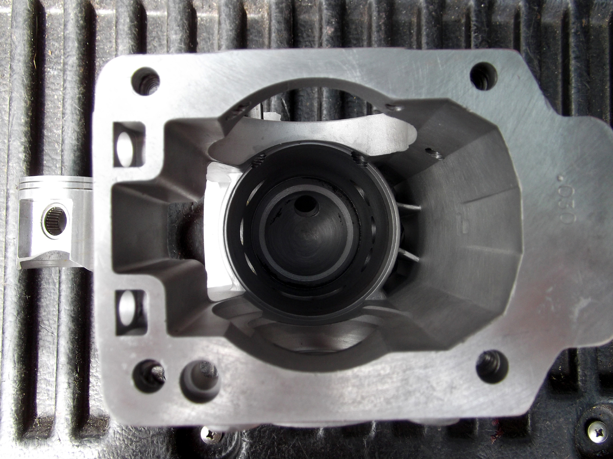

It's an SP block that Terry Ives was able to bore .040" over for me. This block has a cool history - it was purchased early on as a custom block and then sleeved
by Bell Machine Works in Portland, Oregon - a company that re-manufactured McCulloch engines and parts back in the day. They had bored this block up to
.030" over and had ported it. It had substantial wear by the time I got it so it had to go out to .040" over. The piston I have for it is a new Mc101 .040" over slug
that uses the early 9/16" wrist pin and rod (different from the SP pin and rod).

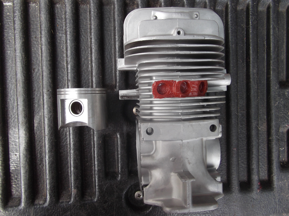

Bump - This was a build I did this spring and then had to tear down again due to movement in the clutch side bearing pocket of the block. So it's back up and running with
a different .030" over block and a new 101D .030" over piston.
