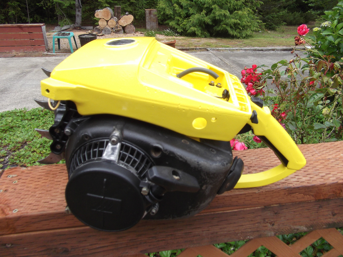

Well Jacob, You unraveled a mystery for me. The first pic in this last post. Your cylinder cover has a
reinforcement repair part for the lower screw for the fan housing. I have a few and never knew what
they were for. Thanks Buddy.
