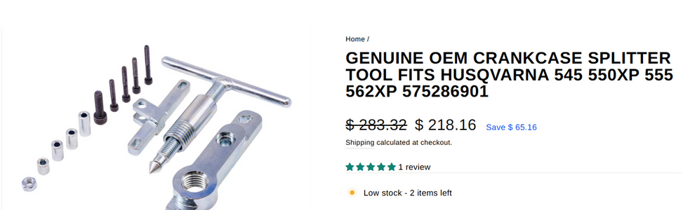

I have rebuilt a couple 562’s, but in the end I got factory shortblocks. Both times I rebuilt them, the bearings failed in less than five hours. If you need a crankcase splitter, I could sell you mine.
How much do they run, and does it only split husky’s???
hacskaroly
2100 Fanclub Member
9:55 PM
27954
Nov 24, 2023
3,267
10,578
Northern Idaho, Ehh
Not sure how much they run, but there are specific splitters for Husqvarna 5-series saws that have crank stuffers. The typical splitter has a bit that straddles the crank inside, but with stuffers they get in the way and another type of splitter is needed.
