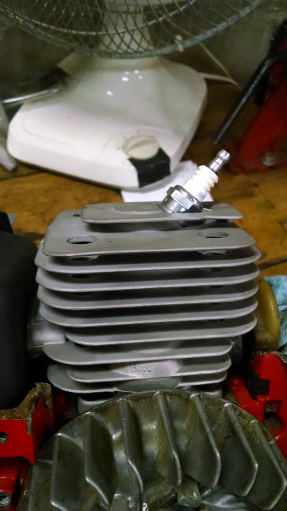

Anybody have any luck getting burnt on Gunk off the outside of a cylinder? I even tried the typhoon parts washer at work.
Bead blast it. Here's the cylinder on the 930 I'm building.
