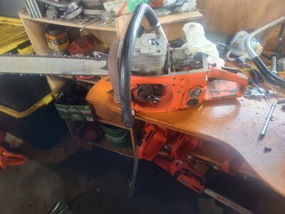

Ok, so I tried to heat up and bend the 2100 throttle rod today to make it work with the 394xp carb. It never fit great and when I thought I had it it would bind when pulling on the throttle. Ended up with a fairly straight rod and still no dice. Any suggestions? Good thing is I bought 20 on sale so I have 19 more tries 🤓
Maybe figure it out with brazing rod then match it up. That stuff bends, unbends, and bends again pretty well, but holds a bend too. There's a word for that probably. The type I've got does anyway.
Got a 2100 carb selection you can pick from if it comes to that.
I have used bicycle spokes for throttle rods, after bending it, temper it with heat and then oil bath...worked out great for an 075 with a NLA throttle rod (the long one, not the short one).
Never considered doing that. Should work well and there are different gauge spokes to choose from. Brazing rod is a little on the thick side.
I just tig weld in an extension into the OEM rod.
