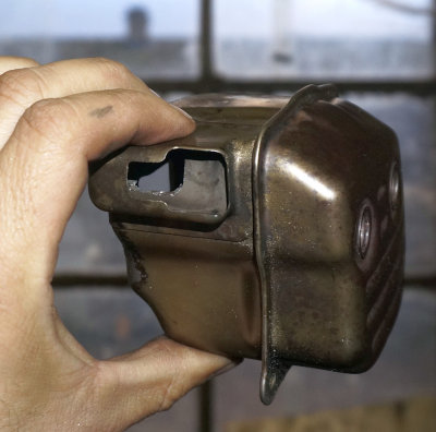

Just make sure when you go to the ported testing phase that you don't bury the bar so deep in a chestnut that it now has difficulty clearing chips(which is usually unusual for an ms261):
These mofos get loud if you are generous with the exhaust opening:

Very nice runner, clearly a much faster cut.

The V2 muffler doesn't have that tube in there, I'm assuming thats the reason the V2 261 runs better in stock trim than the first model.
You can tell just by holding the 2 mufflers how much lighter the V2 muffler is.

It's not really a tube in the first version - more of a shelf. It forces the gases all the way to the front, and then it has to do a 180 to get to the tiny exhaust hole.
Having said it, this was still a very drastic exhaust mod, regardless of what baffle or not may have been there. It is a hole nearly as large as the exhaust outlet is at the cylinder, and the outlet it is very close to the cylinder as well. You can even tell in the video how much louder the thing gets when it's done:
But, to be fair, it was also done in very cold and dense/damp conditions(nov 27th after a rain). On a hot, dry day, the difference may not have been so much. And since the saw was having trouble clearing chips, it is also faster ported than one might think.

Whatever you wanna call it, just bolting up a V2 muffler makes a big difference over the old one.
