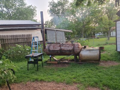

Please excuse the less than pretty welds.
6' ladder for scale. Used a 24" 3/8" wall pipe for the firebox liner, it's about 42" long. Easy to move fire forward or back depending if you want even heat on the grates, or a hot spot on one end.
About 4-5 splits to get to temp, then one every 45 mins or so once it's got a coal bed.
