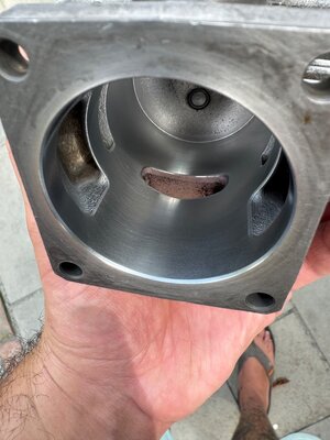

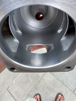

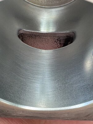

Got home from work and had a few minutes to clean the cylinder before my husbandly duties started. I’m back to where I was before. Does anybody with a more experienced eye see anything I’m not seeing. Could the exhaust port chamfering have been damaged from before or even from the scotch brite that I can’t see or feel? I used maroon scotch brite and purple power, should I go over it with something finer?
Yes, the affected ports from the previous mishap should be re-chamfered to get any hangers-on off the edge and bore gone over lightly to ensure the chamfer job didn't make a new spot to booger things up again.

I was thinking maybe something sharp on the exhaust port. I just posted some pics it’s hard to get a good angle but maybe you would know what to look for.
The metal smear will hang off the edge of the port like a tooth on a crack head.

Someone correct me if needed.
What I said before and then what Kevin said …
To be sure all the transfer has been removed use a bit of acid (mutaric) and a few seconds to see if it fizzes..
Others may not do this if there competent enough. But I like a guarantee what my dumb eyes can’t see. 😉
Simple Green in a USC Seems to help sort the AL Transfer 0n the cyl (The Color) Hard to explain. My Fingernail isn't as trust worthy as a pick when I am checking if the transfer is Proud on the plating or if it is a gouge/score. Reading BRAIL in fine print would be impossible for me.

Strong Island NY
I agree with the polished aluminum transfer sitch. It’s happened to me. Do the acid on the Qtip method all around the ex port. I’d rechamfer the port with a fine diamond ball as well. The fly side floor looks odd to me. Could be an illusion.

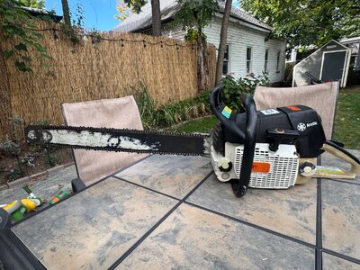

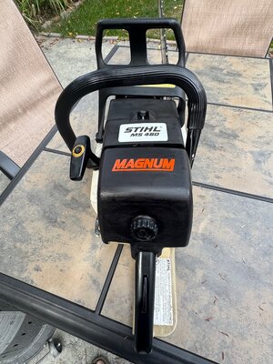

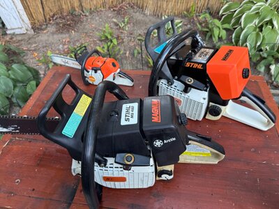

Finally an update! 😂 I got the 460 back together and had time for a quick tune before I had to pick the kiddo up up from daycare. It sounds and feels great! I’ll have more time tomorrow to make final carb adjustments with a tach. Lightly sanded and dyed the plastic while i was bored waiting for the cylinder to get back from the porter and parts, I really like how old plastic comes out matte black instead of shiny. The heated handles work and threw on an old 32” Stihl wide nose bar, I wish Stihl didn’t stop making those. I’ll hopefully tune it in wood this weekend. Thanks for everybody’s input!
