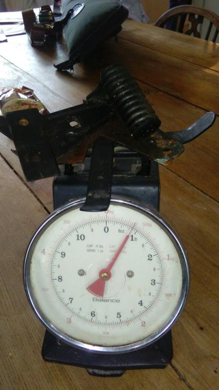

Totally empty. It is the same saw with the small spike removed and the large dogs and large wide cover. The large dogs are quite heavy.
Saws start to pile on the weight quickly when you add things. Here's the 7th mount and outside dog on a 281/288xp coming in at nearly 14 ounces - the outer dog is 5 ounces:

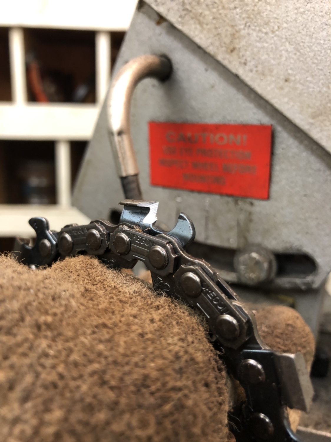

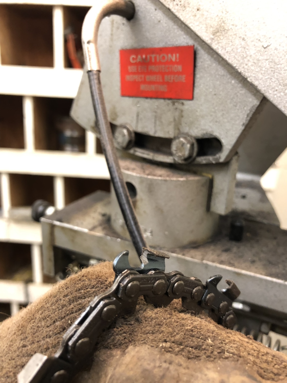

Any saw comparisons must be run with same bar and chain. Or at a minumum same chain. Same wood. Same operator. Same cutting style and pressure.
Same operator same wood sure but you don’t need the same chain just the same stops set on the grinder, if you use the same chain each cut will be duller.
I think that is the best and if they are from the same manufacturer and with the same cutter length and fresh dressed and rakers technically gauged from raker to tooth. Does this make any sense? Not a grinder guy though
