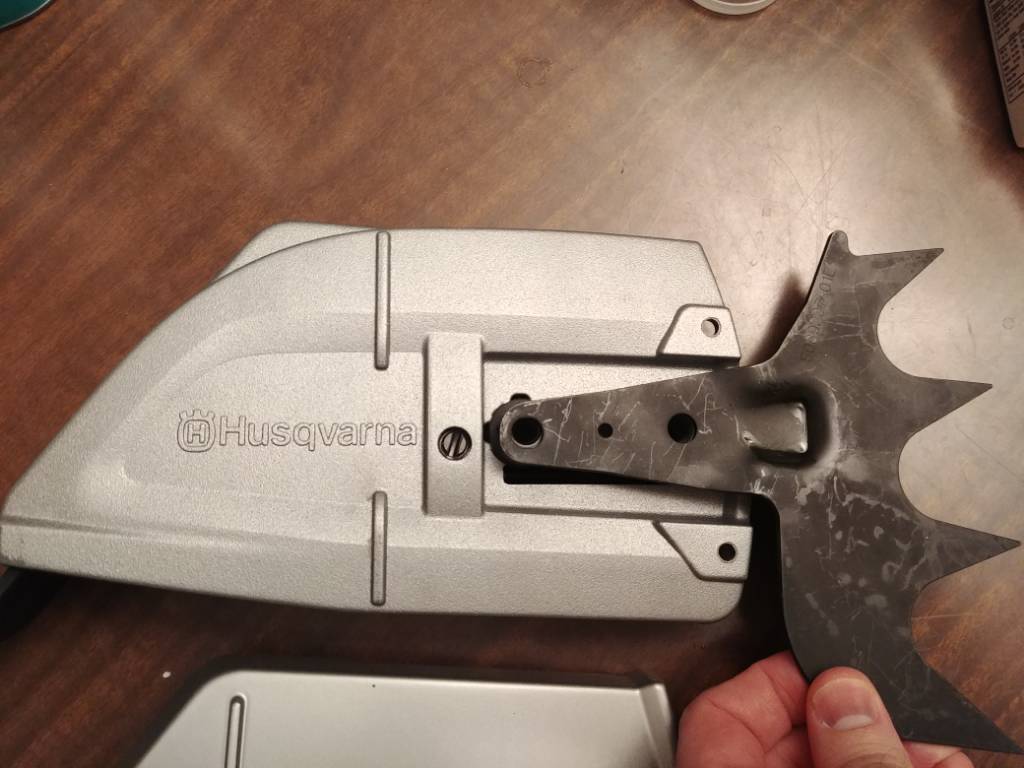

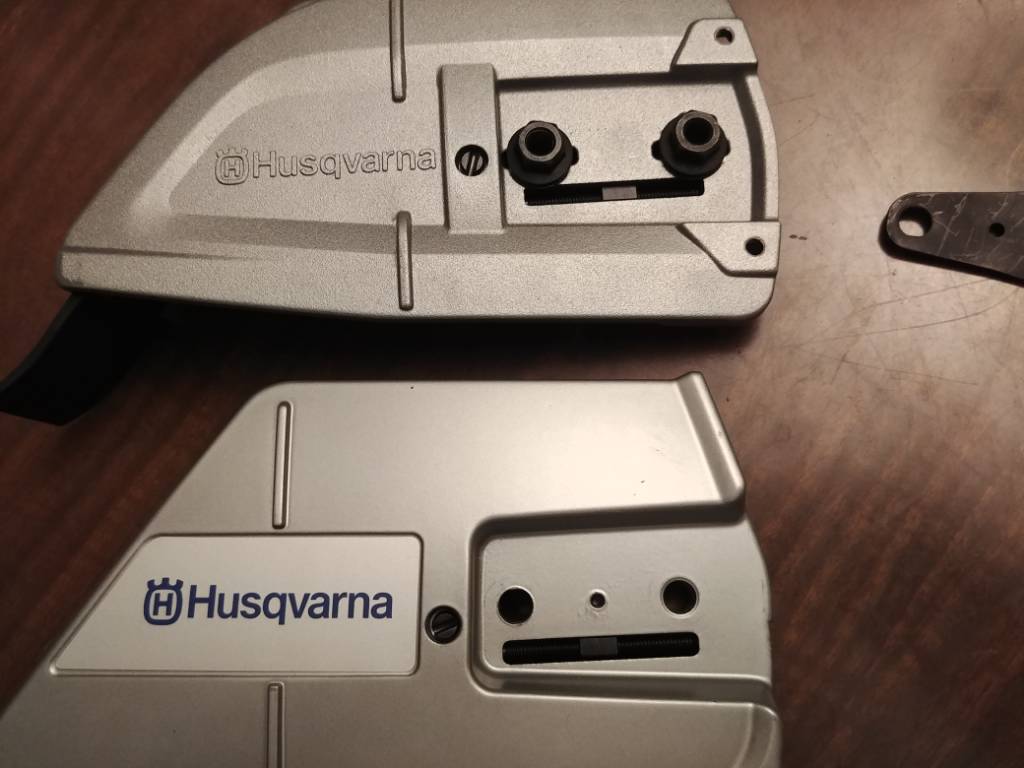

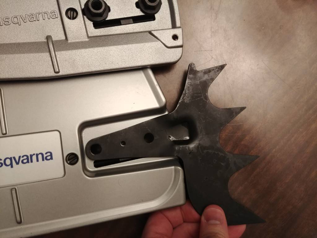

I thought taking off the captive nuts and running standard ones you’d be able to run a outside 372/390 dog? Or does the raised area in front of the stud not let you do that?
Ok I see. Yes there is a large lip at the front of the cover that prevents the use of the dogs that fit on the bar studs. The dogs that fit the stock cover mount to the front of the cover itself.

It does look like the dog would fit if you where to grind off the lip and use regular bar nuts.

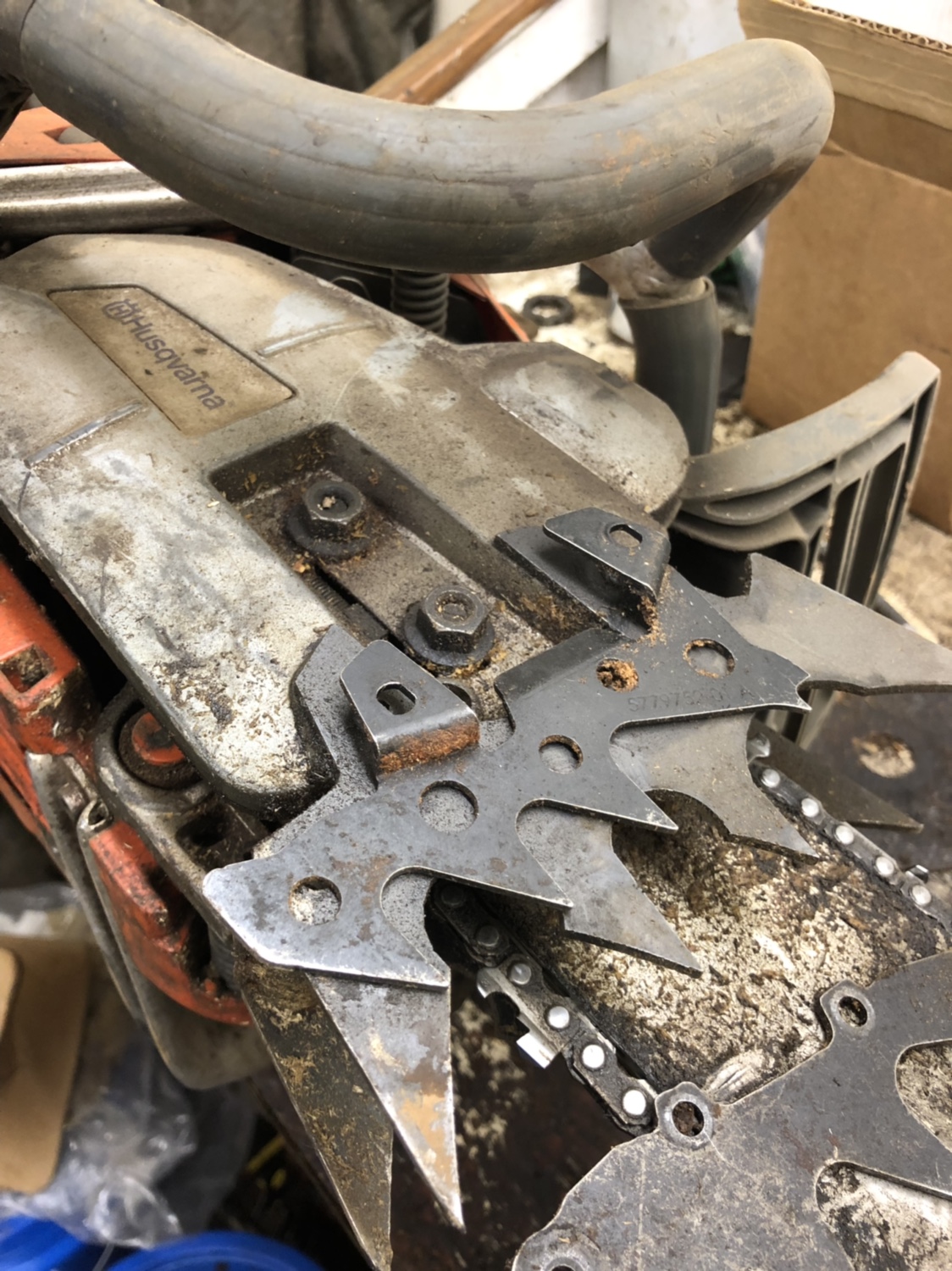

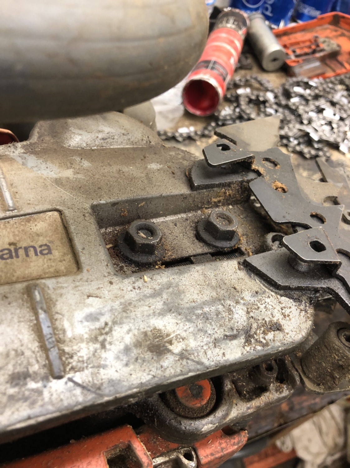

Roughly 2 5/8” center
Stock on top, you’d need a set like I have on the 562 to fit that style of cover.
Yeah but most want the bigger ones. .Cool if you could find out the 562 small ones fit though. . I love the dig dogs you made. They don't drop low like the AM pro safety's. Much better control. Nice job.
Metals406 on AS cut them for me wish I could take credit for them but they work great. The small stock ones wouldn’t dig in the thick second growth fir bark we cut these will actually stick in the tree if you need to get up on a board which is a huge bonus.
