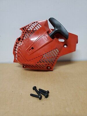

Apparently that saw came easy start too. as the cs2238s. You could just swap starters for less effort than adding a decomp.
The part number is 545180813 for the easy starter.
Here's the oem easy starter for $31 shipped of the bay. It says its on sale for 10 more hours and then it goes up 4 bucks.

One more thing. Regarding the OEM spring assist, regardless of brand. What puts the spring "under tension" so that it "wants" to help turn the crank? With a conventional pull-start, you pull against engine compression and the cord rewind spring. Where is the additional spring? What "winds" it?

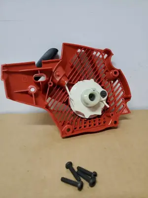

If you look at the photo in the eBay listing, you can see that the center of the starter pulley is a separate piece.
The starter pulley has a conventional rewind spring to retract the starter rope, and there is a second coil spring inside the pulley attached to the portion that engages the pawls in the flywheel. As you pull on the starter rope, the compression of the engine holds the flywheel and that coil spring inside the pulley "winds up". Once the engine eases over TDC the spring is able to spin it fast enough to start the engine.

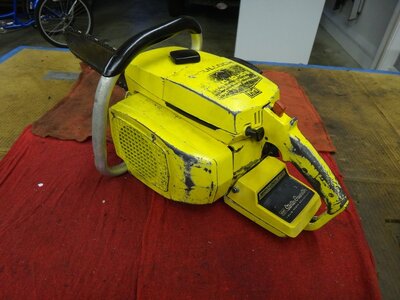

In the 60's, both McCulloch and Remington offered electric start saws. The McCulloch models had on board batteries and a starter/generator built into the flywheel of the saw. The Remington models relied on and external battery and jumper cables or maybe it was a plug for a cigarette lighter? In many ways, particularly on the McCulloch, the added weight of the batteries and starter rather negated any benefits of an easier starting saw.

Generally, easy starters contain two types of springs: coil springs or hairsprings (similar to recoil springs).
In my experience, the former are more reliable. Some manufacturers switched from hairsprings to coil springs.
Stihl uses, if I'm not mistaken, hairsprings.
