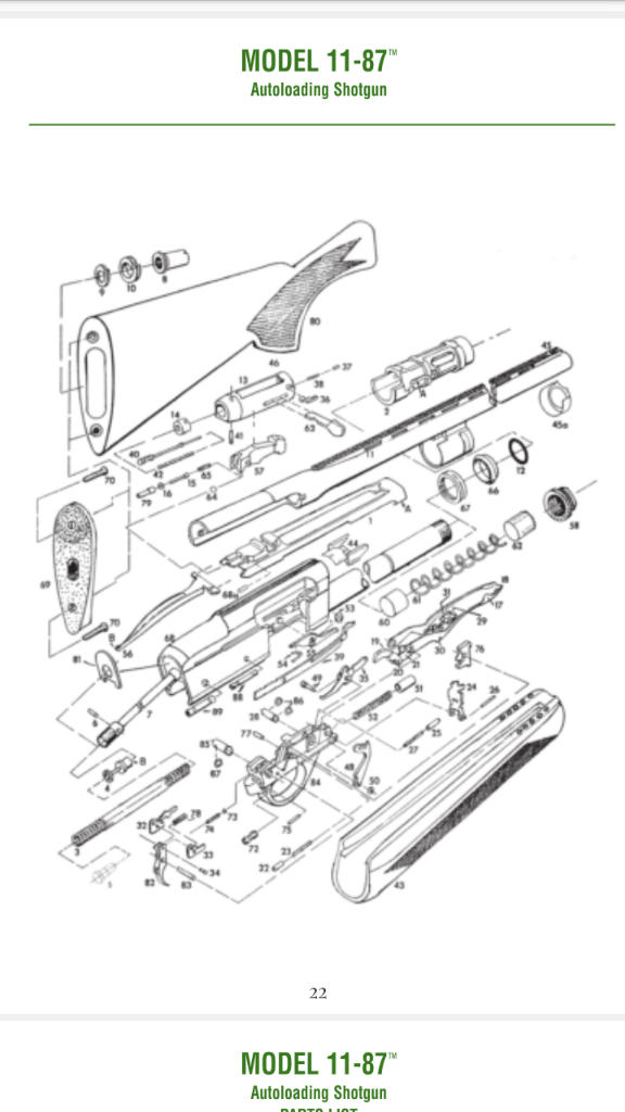

I got out and tries my 11-87. Still not feeding shell in. Just pops out magazine and not tripping the fork like thing that put it in chamber.
So i decided to pull apart and clean again and go over real good. But a thing poped.out that shouldnt have. Think its called a feed latch. Looks like it was in a slot that had peen maks on it to hold in. Will post a pic of part im talking about. I dont think this was the problem though cause it cant move when in place.
I did a little more research and the carrier latch (#24 - 29) or parts of it could be the issue. Check the spring, pin and the latch for worn , loose or bent parts. Apparently the bolt momentarily locks on every shot and the shell coming out of the magazine hits the carrier latch and that sends the bolt forward. The carrier latch holds the bolt open on the last shot when the magazine empties.
I looked at it again and nothing seemes to be bent or broken. Im kinda stumped. The bullet seems to hit the carrier latch thing quite hard.

The spring your talking about is it number three n the parts teardown.
And also how do you get to the spring.

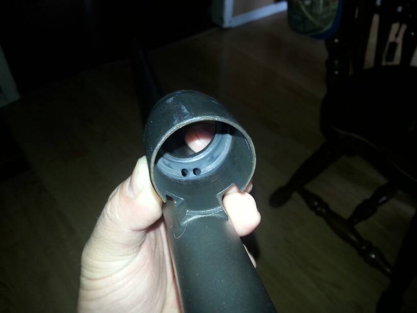

Are these the orifice hole your talkng about.
I seen a spot from inside barel while back but figured it was just a flaw. Didnt realive they were holes.

Those are the holes, make sure they are carbon free. Either use a pipe cleaner or use a small drill bit FREE HAND.
as for the spring...i want to think you have to take the stock off to get to it, easiest way to check if it's working is to press that tuning fork looking thing (#56 looks like a t) towards the buttstock. Make sure it compresses some.

I blew those holes with compressed air ( lightly) and a chunk of crap came of one.
What is the purpose of them holes?

Similar to an AR or AK/SKS, except the gas ports are underneath the barrel.
